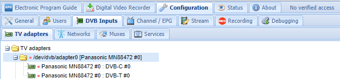

Hi,
I have plug this tuner on RaspberryPi3 with LE8 and 9, i see it on tvheadend but i cant work it because it appears and disappears constantly.
How can i solve that? I attach a video whith this issue
Error XboxOne Tv Tuner on tvheadend on RaspberryPi3 - YouTube
Edit: i have also tried with raspberry zero with the same result
