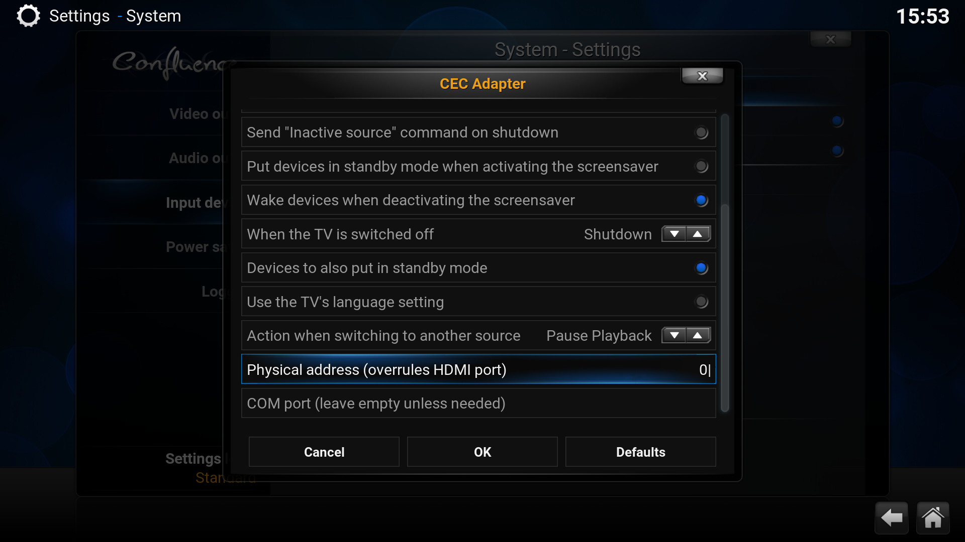

    I don't know if it has anything to do with the HDMI port confusion, but i cannot find any option to choose the HDMI port on the projector. I've seen screenshots where the HDMI channel could be set, but both, the stable (7.0.1) and the dev version (7.95.3) do not show this option to me. A screenshot is attached for the 7.0.3 version. The option to choose the HDMI channel should be right above the Physical address, at least from what i saw on screenshots.
