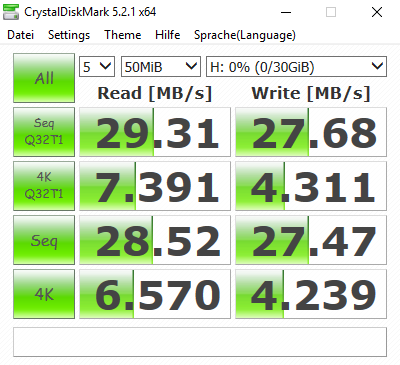

  • Hi Klojum,
    thanks for the quick supply.
    I'm using a Samsung 32Gb Evo Plus, its one of the fastest cards available. See attached stats from CrystalDiskMark. (I will add this to the first post)
    I only added about 100 Movies for testing and it was still blinking after 2-3 hours. So I doubt that it was still doing some caching.
    Chris

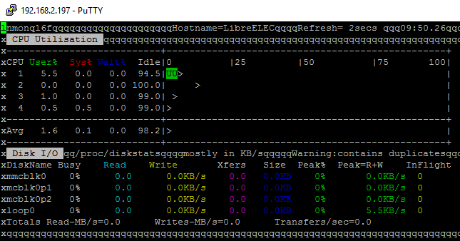

  • Adding movies for the first time can take a long time, even after scanning has completed as it has to extract codec information from each file.
    Your best bet is to install LE addon System-tools and use nmon from ssh to see what is actually happening - cpu, disk I/O etc.
    Have you checked /storage/,kodi/temp/kodi.log? for any clues. Post log file if you cannot see anything obvious.
  • Thanks for the comment.
    I installed system-tools and looked at some values. (c and D, see screenshot)
    It shows no traffic on the Disks, but the green LED is still blinking?! Any other values I should look at?
    Here is kodi.log
    Couldn't see anything obviously wrong here either?
    Could a be something special with the Raspberry PI 3 in contrast to PI 2?
    The LED is blinking very constantly (not like write acess to the SD Card). Just like someone programmed it to blink once a second...
