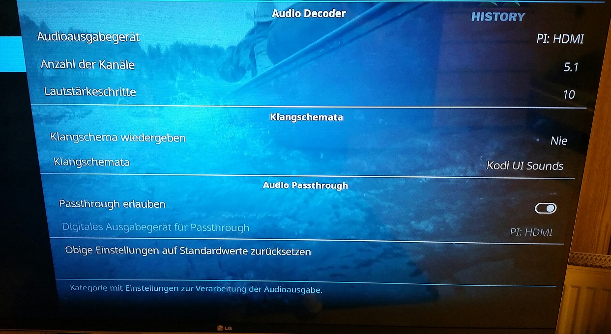

    If i now go on Live-TV in Channel list and klick "X" (PS Controller) on a Channel he open the Channel in the Background in front is the TV-List and all ist working.
    If i now press (O) he is showing me the menu from Kodi (Sound is working).
    If i now press (O) and he close Menu and show Only TV-Screen my sound is away (If i now switch the Output-Channel from Ligawo Switch to another and Back to Raspi Sound is working) - (If i change Channel without closing the TV-List the Sound is working, until i have only TV-Pictrue)
    If i now press (X) to close Channel-List to view only Channel the sound is too going away. (If i now switch the Output-Channel from Ligawo Switch to another and Back to Raspi Sound is working) - (If i change Channel without closing the TV-List the Sound is working, until i have only TV-Pictrue)
    It looks like the is a signal or the signal will be lost if i change to TV-Screen ONLY. I Think my LIGAWO Switch think i switched the input or something else.

    Kodi Soundsettings in attechment.
