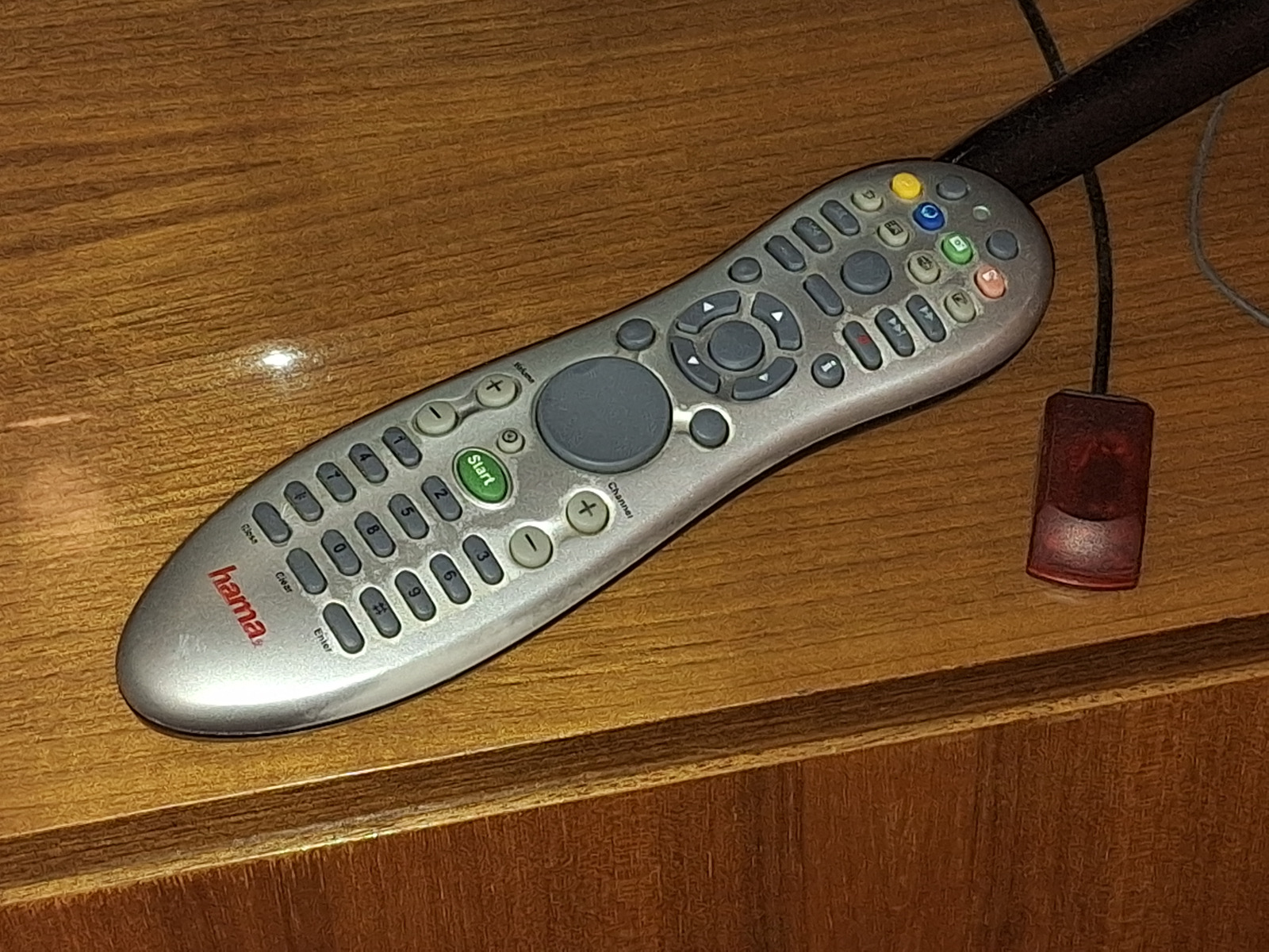

  • It is an old IR Remote from Hama connected via USB dongle.
    /proc/bus/input/devices:
    evtest:
  • Thanks for the info!
    This remote is a bit of a bitch (I have the Gmyle branded version here in a box), both the "i" button and the "right mouse" button generate the same button/keycode (BTN_RIGHT - right mouse button - which will bring up the context menu when you place the cursor at some entry).
    Previously we had remapped those two buttons to KEY_INFO via eventlircd, and I guess I should include the same mapping in LE13 - that remote was somewhat popular in the past.
    For now, please create a /storage/.config/hwdb.d/99-remote.hwdb file with the following content, then reboot.
    evdev:input:b0003v05A4p9881*
     KEYBOARD_KEY_90002=info
    Please report back if this works for you, too.
