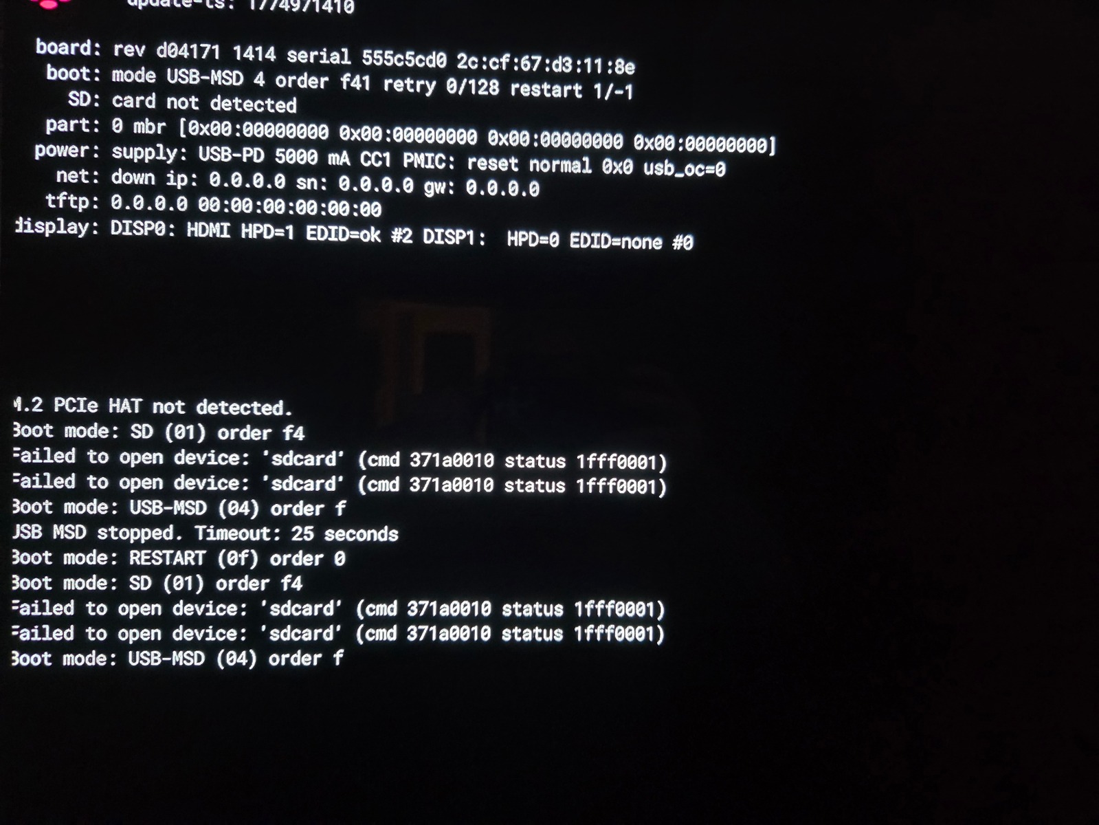

    My problem:
    I'm using the same cable and the same HDMI port on both the TV and the Raspberry Pi (HDMI 0) for all tests.
    I've also tried other high-quality cables and different HDMI ports.
    1) On the new Philips TV: everything works as expected, including Remote Control CEC.

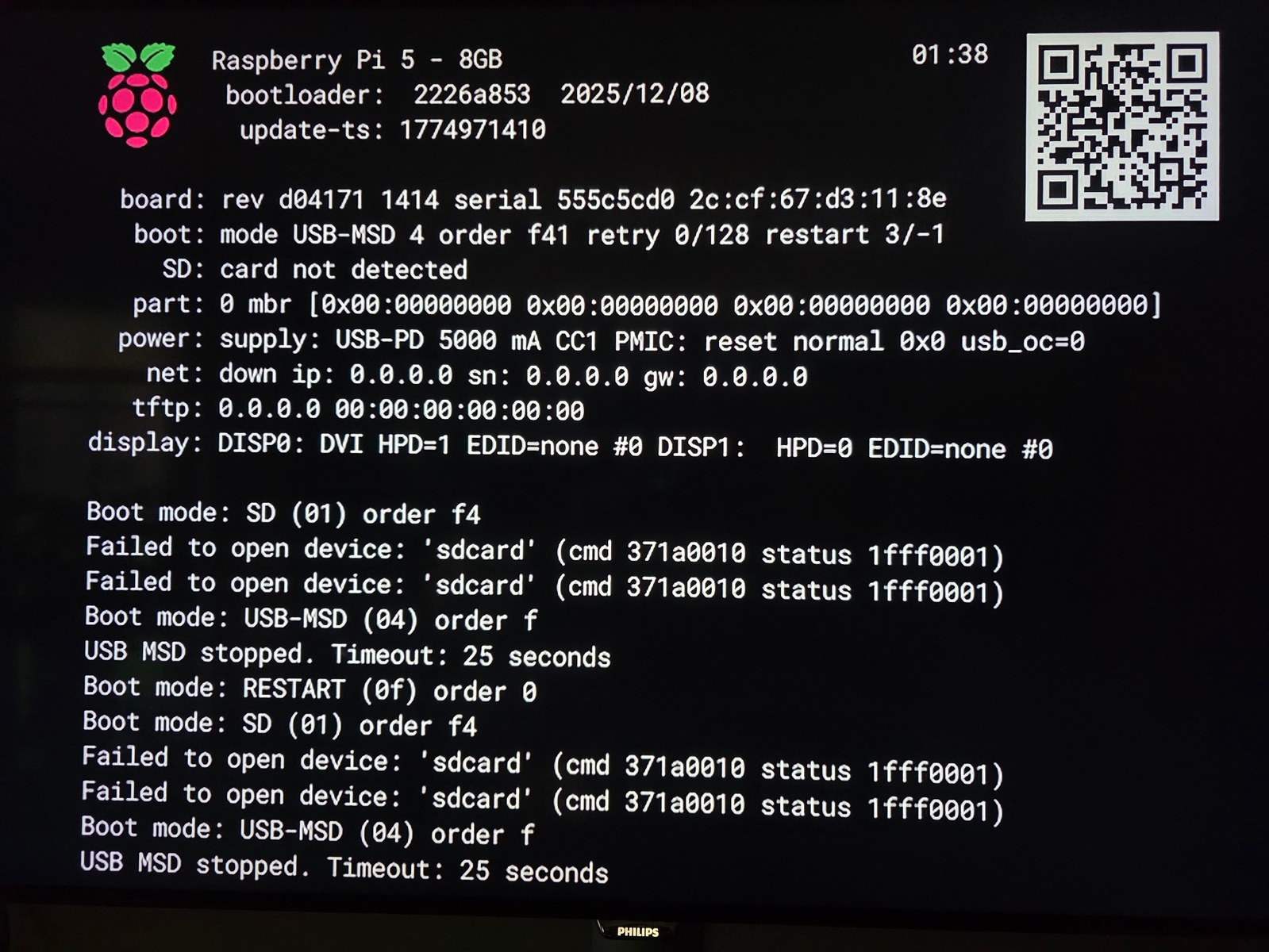

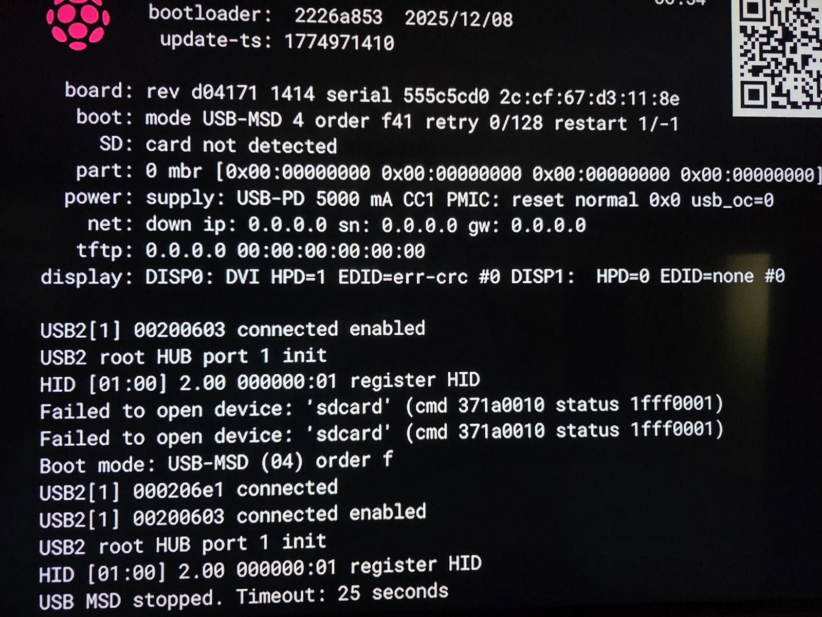

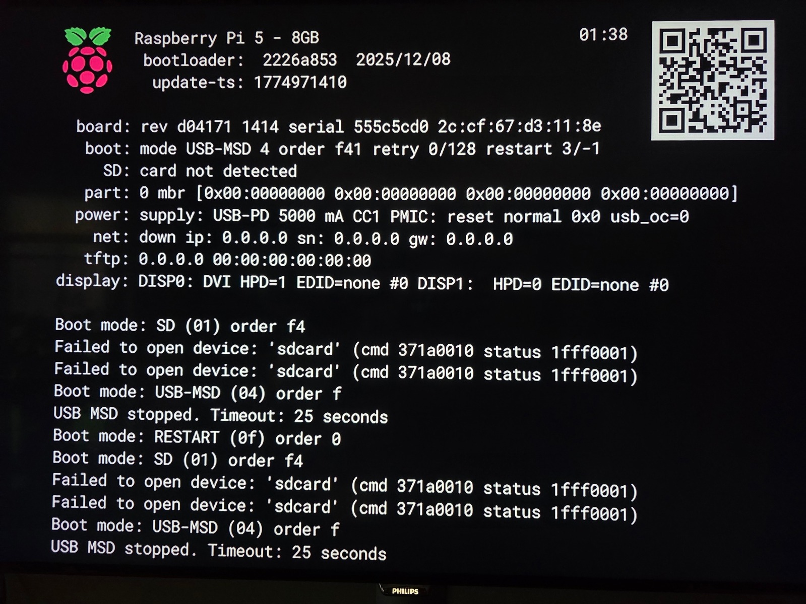

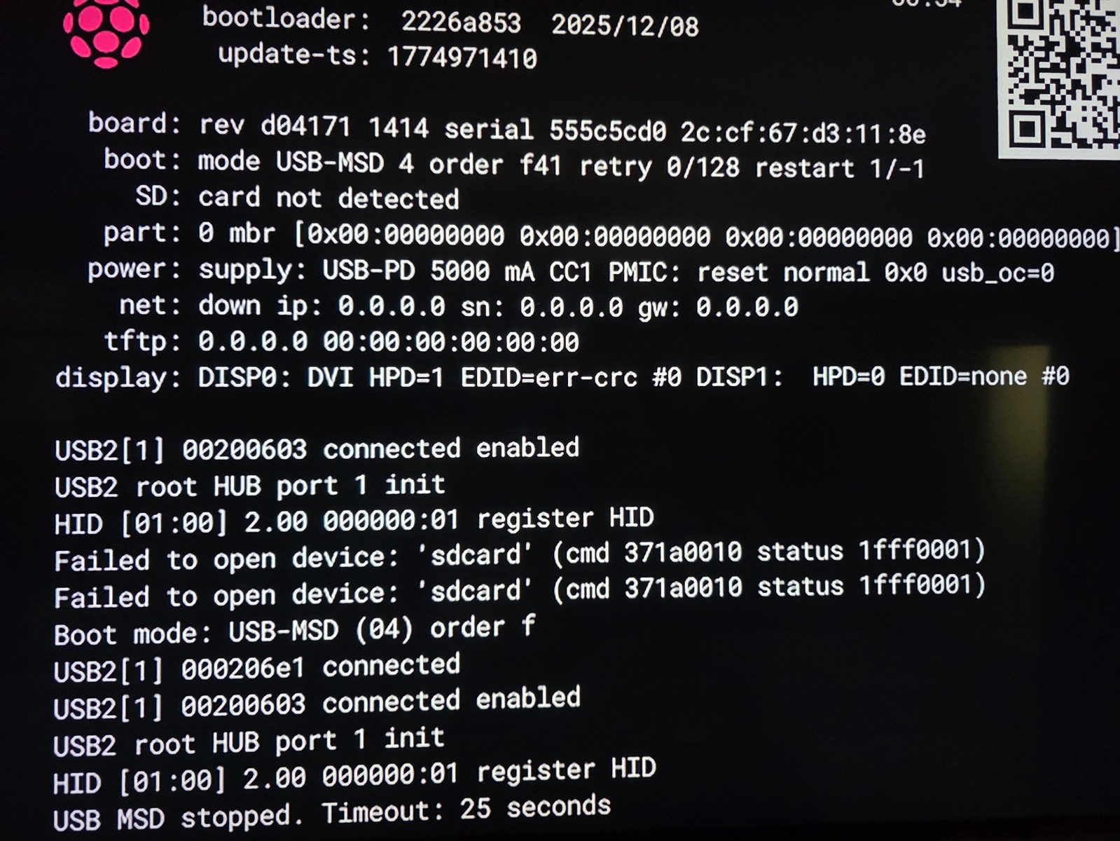

    2) The problem occurs with the old Philips TV, which previously worked perfectly with the RPi4 and LE12.
    Connected to HDMI 0 (near the USB-C port), the RPi5 is only recognized as DVI by the old TV, and EDID doesn't work either.
    When I use HDMI 1 on the RPi5, the old TV recognizes the RPi5 as an HDMI device, but CEC doesn't work on the HDMI port :(
    3)For testing purposes, I installed LE10 on the Raspberry Pi 4 2GB.
    The TV recognizes the Raspberry Pi 4's HDMI 0 port as an HDMI device, and everything works.
    In my opinion, it can't be a hardware issue.
    - 1 (or more) cables that all worked
    - 2 different Raspberry Pis that also work
    - 2 TVs that also work
    only the Raspberry Pi 5 and the old TV don't work :( I even unplugged the TV for 10 hours.
    It works immediately with the Raspberry Pi 4 and LE10
    Do you have any ideas what else I can try?
    Thank you in advance.

  • Then better go to the RPi forums. If only the second HDMI port shows HDMI/EDID in the bootloader but not the first one then this could also be a hardware fault of the RPi (in that case you should return it to the seller for a replacement) - but double-check with the RPi folks, they might have another clue or advice for you.

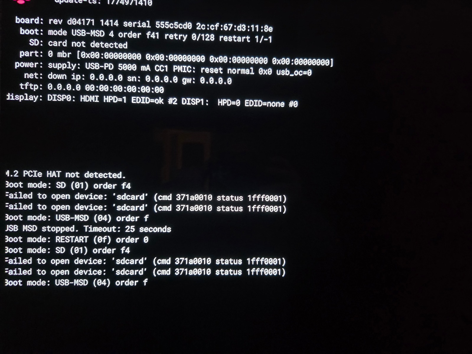

    I've made some progress.
    I connected the Raspberry Pi 5 to the new TV, ran "getedid create," and restarted it.
    After that, CEC stopped working.
    Then I connected the Raspberry Pi 5 to the old TV and now I'm getting 1920x1080p60 via the HDMI 0 port near the USB-C port.
    But unfortunately, CEC still doesn't work.
    I'll keep trying!

  • update :)
    After HDMI 0 finally started working, I disabled/re-enabled the TV's Easy Link function, switched the HDMI input, and then back to HDMI 1 on the TV, and Pulse Eight connected. :)
    Sometimes, after restarting LibreELEC, I have to switch the TV's HDMI input and back again for Pulse Eight to connect.
    But I can live with that. :)
