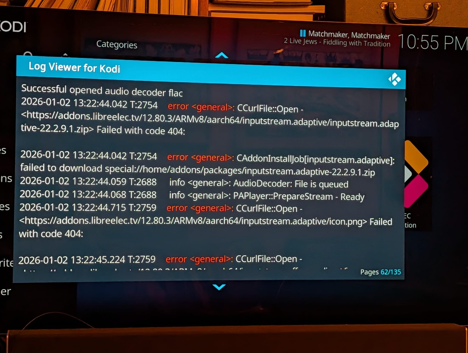

Its available as an addon
2.2.91 fails install
Not sure the version you are referring to. The addon versions are (depending if you are running LE12.2 or LE13):
- 22.3.6-Piers
- 21.5.18-Omega
Please share the logs if still an issue.
its calling 22.2.9.1 zip
The image you are using is a previous release of LE13. Please update to the current release to be able to install addons. The current addon releases are 12.80.5. You will be able to find the current LE13 images at - https://test.libreelec.tv/13.0/
Thank you that solved it.
