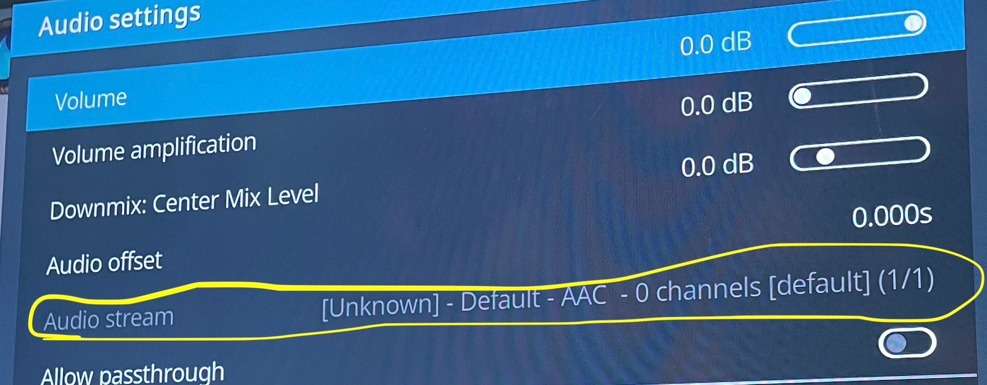

    So I reverted or downgraded the failing one to the same build version - v7.3.0+beata.1 - and the sound again works. Interestingly, I noticed the audio stream on the one that was failing to have the stream information:
    Thanks,
    A.
