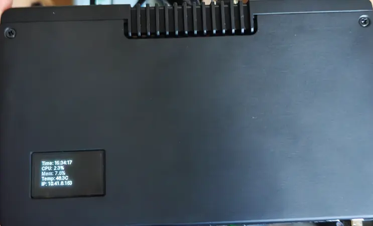

Hey guys, I got the Argon ONE V5 case and OLED module today and had similar thoughts to OP (I also use the NVMe add-on but this just works straight out of the box). I got this working by using the Argon ONE Control add-on and Docker (add-on) with Python to run a script, where the I2C of the RPi5 is passed through to the Docker container (uses luma.oled).
1) Install Argon ONE Control add-on (enables I2C, fan, power button, temp controls)
In Kodi:
- Add-ons → Install from repository → LibreELEC Add-ons → Program add-ons → Argon ONE Control → Install
- Reboot to complete install
2) Verify I2C is enabled and can see the OLED module
SSH into LibreELEC and then run:
You should see the OLED module at 0x3C
3) Install Docker Kodi add-on
In Kodi: Add-ons → Install from repository → LibreELEC Add-ons → Services → Docker → Install
4) Create the OLED script
Create a directory for the script and then create oled_stats.py:
Paste and save this:
Python
Display More# /storage/oled/oled_stats.py import time, psutil, socket from datetime import datetime from luma.core.interface.serial import i2c from luma.oled.device import ssd1306 # change to sh1106 if your panel uses that controller from PIL import Image, ImageDraw, ImageFont # I2C bus 1, common OLED address 0x3C (change to your I2C address if not 0x3C) serial = i2c(port=1, address=0x3C) device = ssd1306(serial, rotate=0) font = ImageFont.load_default() def get_ip(): # Works because the container uses --network host s = socket.socket(socket.AF_INET, socket.SOCK_DGRAM) try: s.connect(("8.8.8.8", 80)) ip = s.getsockname()[0] except Exception: ip = "0.0.0.0" finally: s.close() return ip def read_temp(): with open('/sys/class/thermal/thermal_zone0/temp') as f: return int(f.read()) / 1000.0 while True: img = Image.new("1", device.size, 0) draw = ImageDraw.Draw(img) cpu = psutil.cpu_percent(interval=None) mem = psutil.virtual_memory().percent temp = read_temp() ip = get_ip() now = datetime.now().strftime("%H:%M:%S") lines = [ f"Time: {now}", f"CPU: {cpu:4.1f}%", f"Mem: {mem:4.1f}%", f"Temp: {temp:4.1f}C", f"IP: {ip}", ] y = 0 for line in lines: draw.text((0, y), line, font=font, fill=255) y += 12 device.display(img) time.sleep(2)5) Run the OLED container
Create and run the container by copying/pasting the below into your SSH session
Display Moredocker run -d --name argon-oled \ --restart=unless-stopped \ --network host \ --device /dev/i2c-1 \ -v /storage/oled:/app \ python:3.12-slim sh -c " apt-get update && apt-get install -y --no-install-recommends libjpeg62-turbo-dev zlib1g-dev gcc python3-dev && pip install --no-cache-dir pillow luma.oled psutil smbus2 && python /app/oled_stats.py "6) Interacting with the OLED container
- Container Logs: docker logs -f argon-oled
- Restart Container: docker restart argon-oled
- Stop/Start Container Manually: docker stop argon-oled / docker start argon-oled
- Remove Container: docker rm -f argon-oled
The --restart=unless-stopped flag makes the OLED container auto-start on every boot
The --network host flag is needed for the OLED screen to show the IP of the RPi5, and not the IP of the bridged docker network/container.
This is just very basic so I'm sure someone who actually knows what they're doing can create something more elegant. -

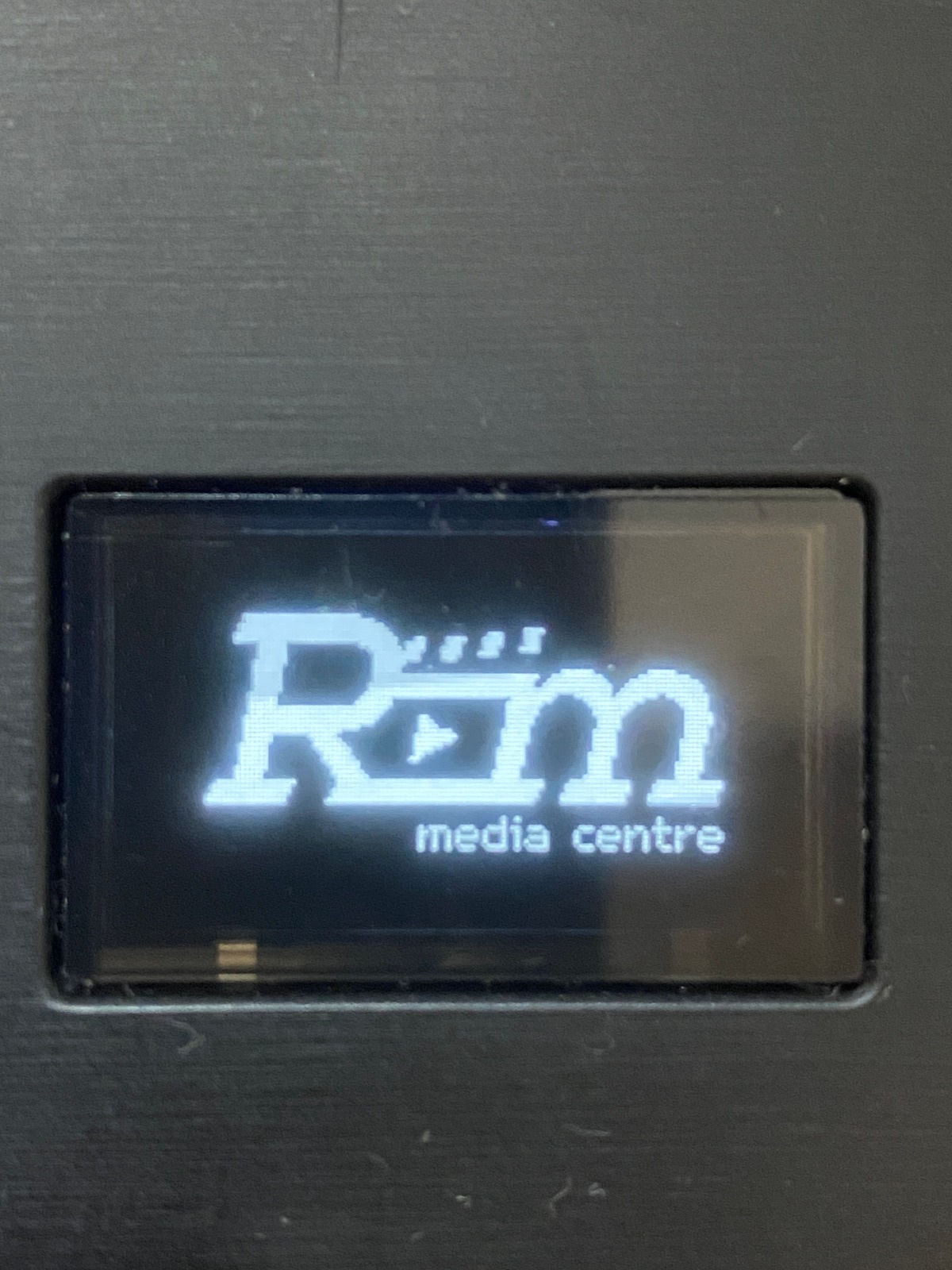

In any case its a lot of fun tinkering with the OLED screen to get it to display what I want it to:

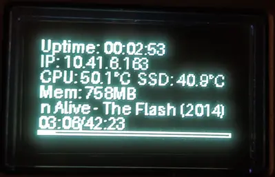

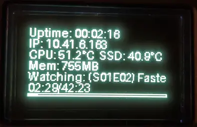

First of all let me say, great work, I have the exact same case and it was a breeze to set up thanks to you.
May I be greedy and ask how you got the now playing and progress bar on your screenshots?

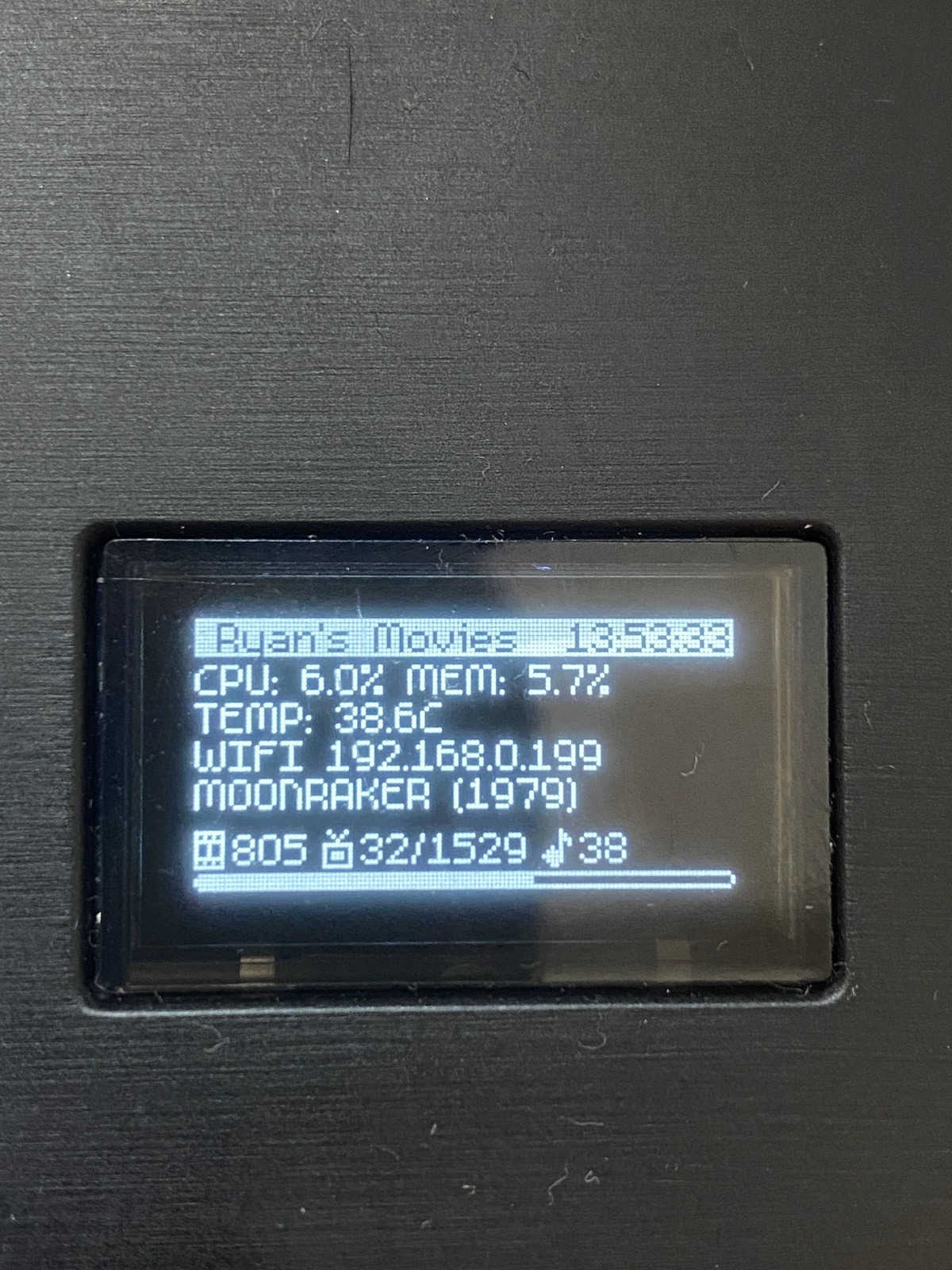

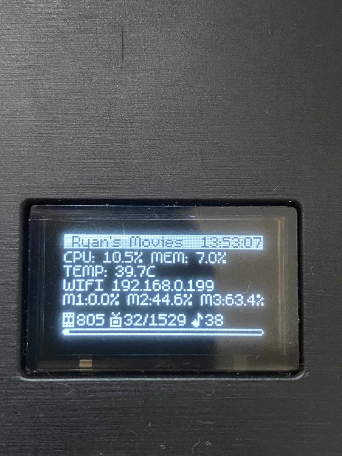

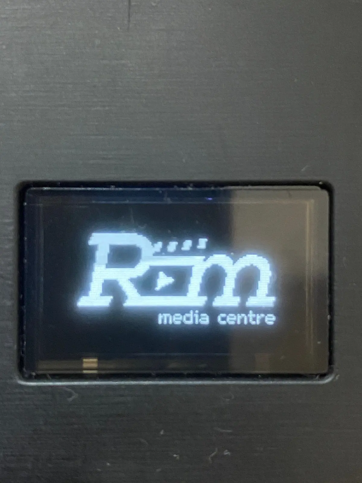

Just wanted to come back and say that since posting this, I've delved into doing it myself and learned SO MUCH! A tinkerer's dream!!
Once I realised that the design layout/gruntwork was done by Pillow, I started making it look pretty: I've got a little boot logo and everything! Then I got into the JSONRPC calls. Between this forum, the depth of info over at the KODI wikis, some Python refreshers and no small amount of "docker restart argon-oled" I now have my little OLED screen looking a million bucks. Thank you again chaosen3! You got me set in the right direction! I'm certain I am doing any of it in a resource-intelligent fashion, but I'm beyond stoked!
