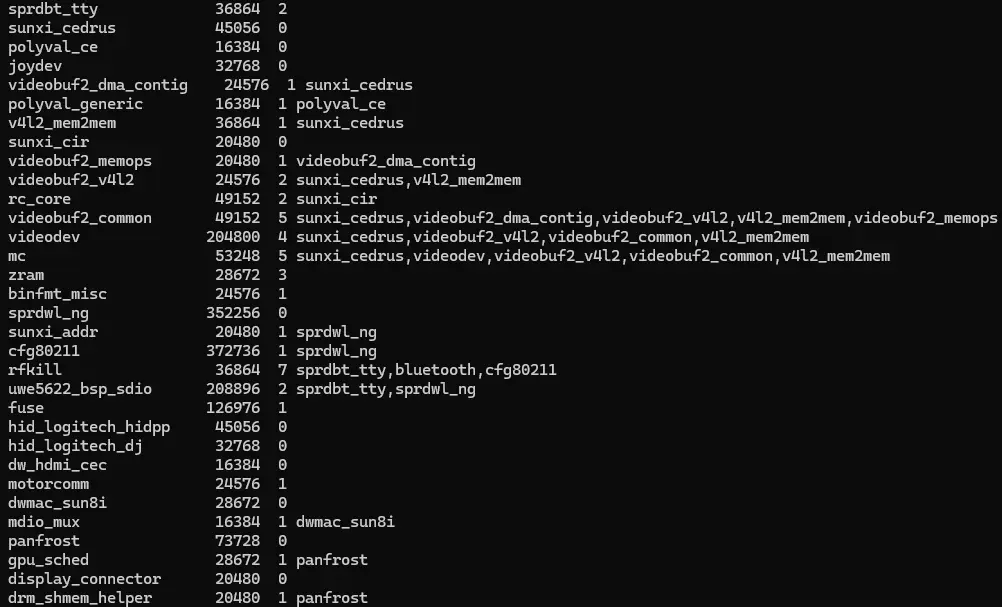

    This is some of the lsmod output:
    Question: Can someone explain why, after what seems to be a successful load of the GPU drivers, videos still don't use them (or maybe all of their capability) ?

  • On an ARM SoC device the GPU is used for 2D/3D rendering (GUI) only and hardware acceleration (codecs) are separate things. As Panfrost supports the GPU hardware the GUI works, while decoding requires specific drivers that need adapting to silicon changes with each new chip. The latter are always non-trivial effort and the gene pool of people with the skillsets for the task is tiny; and most of them are commercial developers not the folks working pro-bono that everything normally depends upon. As such the process is slow .. and support probably doesn't exist yet. Over SSH use 'kodi-remote' to press 'o' on the keyboard to bring up the OSD that shows whether you are using (SW) or (HW) decode; but we already know the answer to that.
