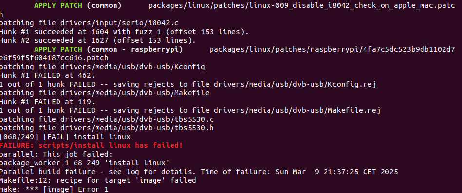

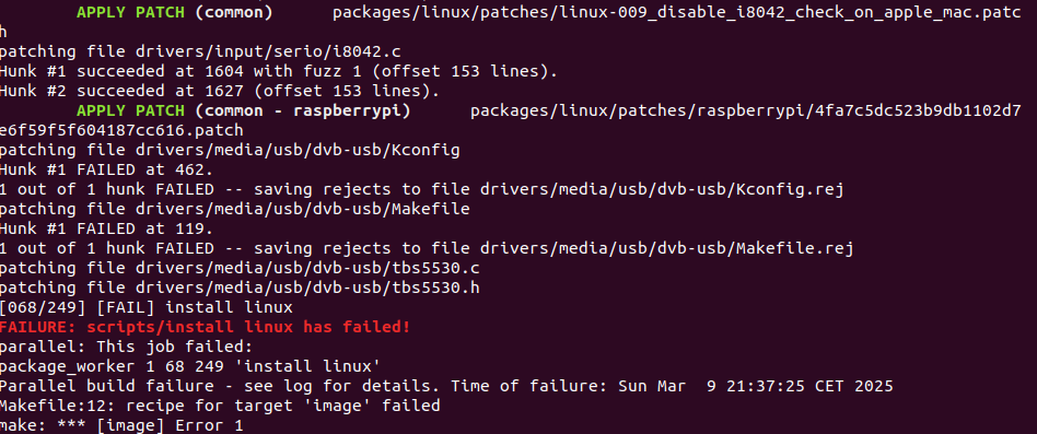

  • alexiedb Clone the RPi kernel (as we use their downstream fork not true upstream for RPi boards) then cherry-pick the patches smp has linked onto the RPi kernel 6.12.y codebase and solve the Kconfig and Makefile issues (simple sort order changes in the files probably) before generating a clean patch to use in the LE buildsystem. Also don't forget to add the related CONFIG_XXXXXX entries and enable the relevant modules in packages/RPi/devices/RPi/linux.arm.conf else the modules will not be built.

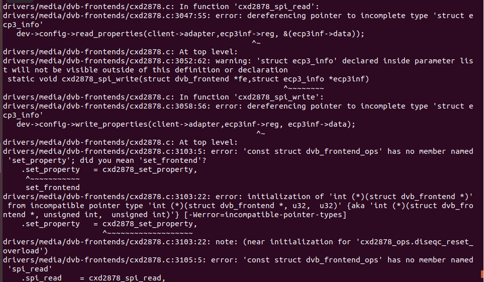

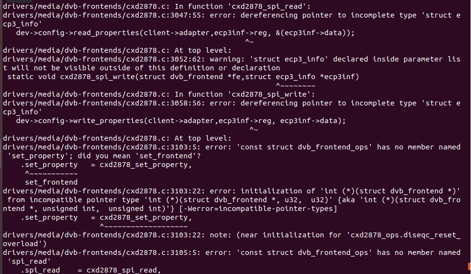

  • Remove/comment out this -
                .set_property            = cxd2878_set_property,
                .spi_read                = cxd2878_spi_read,
                .spi_write                = cxd2878_spi_write,
    and this
  • Now I'm here:
    Anything I can still do?
