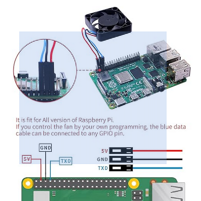

  • The fan is the one in the picture. A standard one with 5V, GND, TXD pins.
    WAKE_ON_GPIO=2 in the bootloader cause the Rpi to be warm even if "switched-off". I don't own a power meter but for sure is consuming more power than the WAKE_ON_GPIO=0 option. In the end it seems one has to play around with the GLOBAL_EN and a slide switch or similar. Not a normally opened button as the one I'm using right now. Anyway it's not really clear to me if it's going to work.
    Any ideas are welcome.
  • Unfortunately, you have not yet answered whether this worked before.
    It is to be expected that WAKE_ON_GPIO=2 consumes more power because a part must be active in order to monitor the GPIO. Have you tried WAKE_ON_GPIO=1 to see if it works? Is there any information about the purpose of the blue fan cable? Maybe you can use it to control/stop the fan just before shutdown. Because if the guys in the linked thread are right, the 5V rail stays on after shutdown.
    EDIT:
    There is different information about the GPIO pin to be used. GPIO14 may conflict with the serial console. Which pin are you currently using for the blue cable? And what does the content of your config.txt currently look like?
    dtoverlay=gpio-fan,gpiopin=14,temp=80000
    Edited once, last by HarryH (February 4, 2025 at 10:12 PM).
