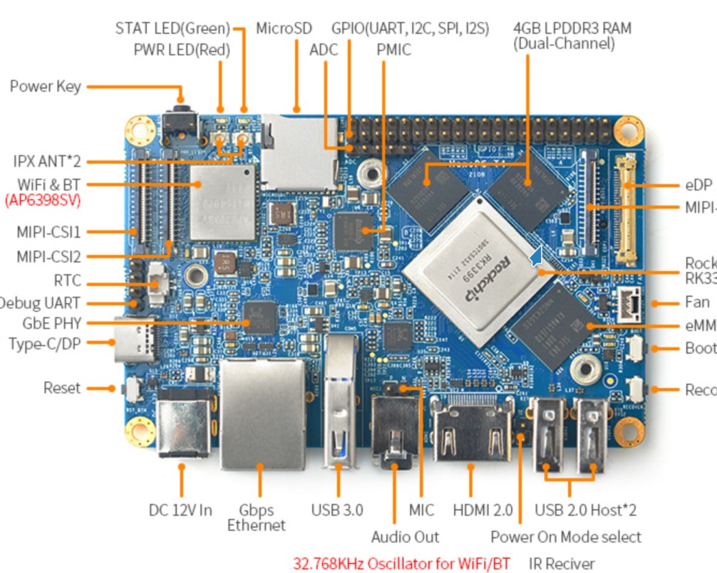

There are two version of Nano PC T4 with different models of WIFI / Bluetooth CHIP
  • The old one USE AP6356S both the WIFI and Bluetooth work well with LibreELEC official images
    The new one USE AP6398SV, with LibreELEC nightly images, only Bluetooth works, and there is no Wlan interface

    currently, there are only new boards for selling
    they mark the wifi chip with read font to emphasize the difference
    any plan to support this?

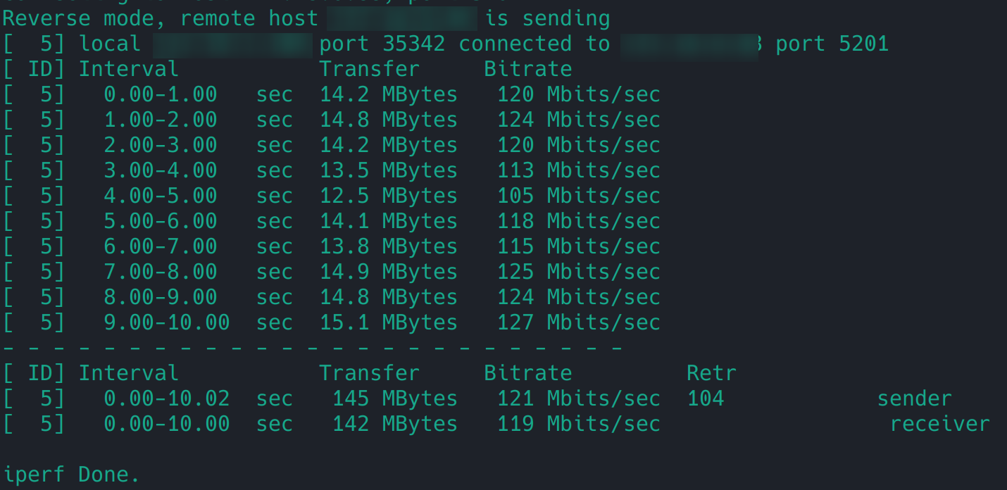

    but I succeeded in making a bcmdhd driver work on kernel 5.10 of LE 10
    And I tested the throughput , and it seems acceptable
