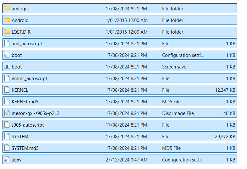

    4). updated uEnv.ini with device tree name updates: dtb_name=/amlogic/meson-gxl-s905x-p212.dtb
    bootargs=boot=UUID=1708-1803 disk=UUID=742745a0-653c-4420-9ef5-6b5faba036fb quiet systemd.debug_shell=ttyAML0 console=ttyAML0,115200n8 console=tty0
    5). SD card inserted in box and started box with reset open following pin into hole pressing button.

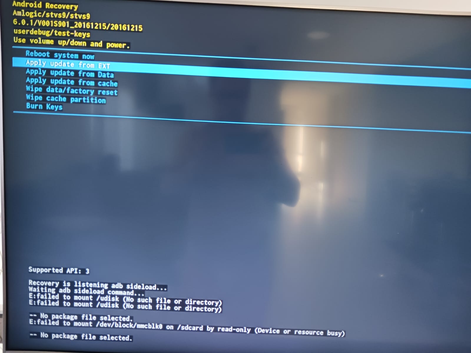

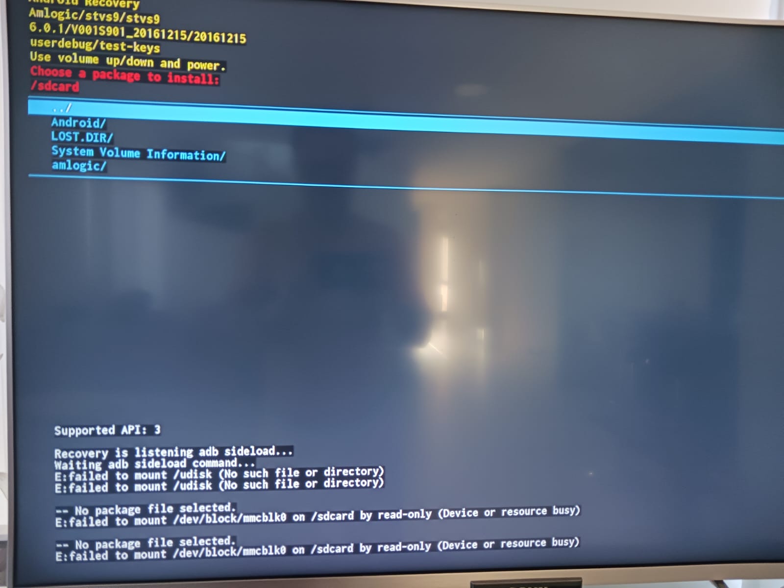

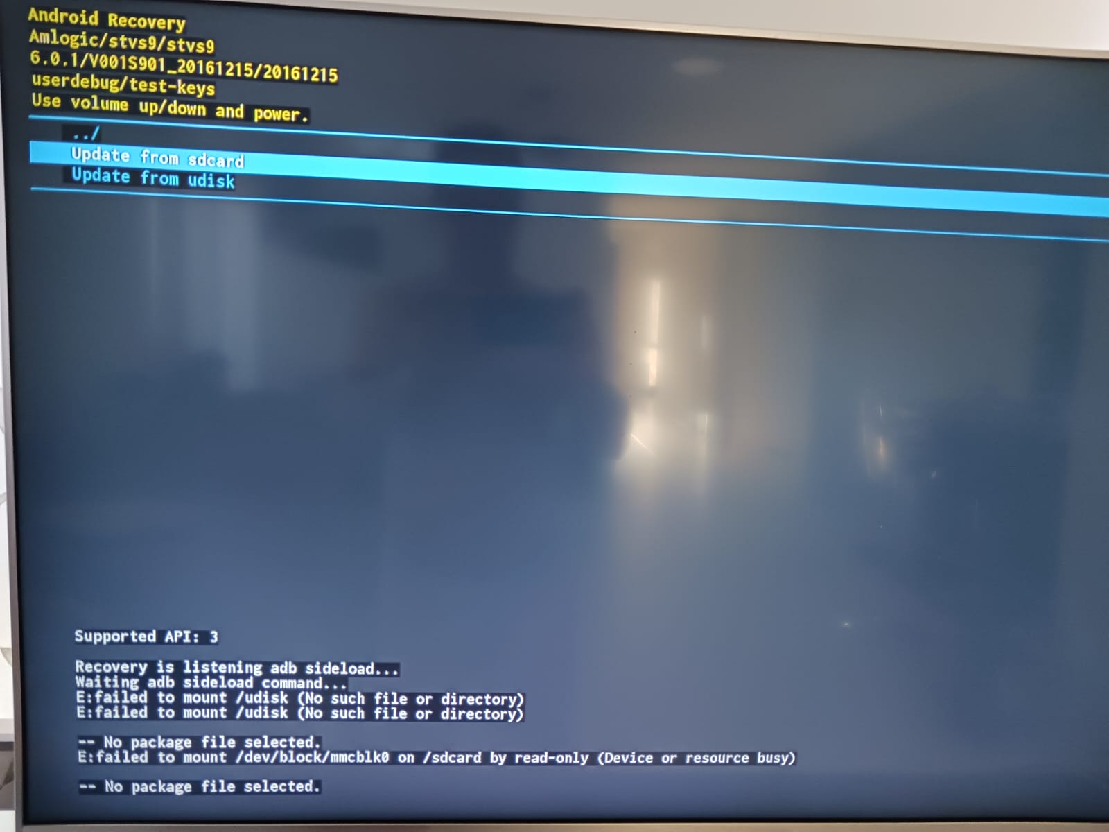

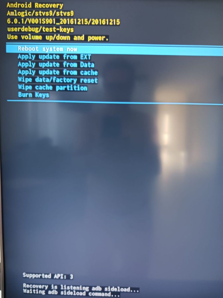

    6). Screen show up to Jadoo 5s logo and then options available from root. I have attached picture here.
    However, I am unable to work out how it will boot to libreelec. this should be automatic but has not happened so I tried to access some options as per attached pictures.
    7). Just incase, I did extra steps to copy and past device tree with ext. change to .img not as dtb.img. but device tree name with.img so i can run under the options of apply update from EXT -> update from sd card -> device tree.img but it fails with same error: signature not validate and process aborted.

  • You need to power the box on with the reset button already pressed, then a couple of seconds later you release the button. In the default vendor bootloader this will force searching for and reading s905_autoscript on the SD card, which modifies the boot flow to look for LE boot files on the SD card (with no renaming). It is not uncommon for some experimenting with button press duration to be needed.
    I suspect you are either pressing recovery after boot or holding the recovery button down for too long, which results in Android recovery boot, which requires Android recovery .img files. These use the same .img file extension but are something completely different to an LE .img file. Renaming LE boot files to Android boot file names will trick Android recovery into loading a file it doesn't understand, but (as you can see) that doesn't achieve anything.

    2). Soon I turn on box within a second Jadoo TVs 5 logo pop up on screen and the reason i though i need a long press to enter into recovery mode and the result show up as per previous photos been attached.

    1). After the previous process I have notice in my SD card folders have another 2 folders 1).Android & 2). Lost.Dir. been added and I am unsure how has been added. I am not too much concern if that's nothing relates to or if its a common? I have attached photo.

    The 'Android' and 'LOST.DIR' folders were created by Android during recovery boot, it's harmless.
