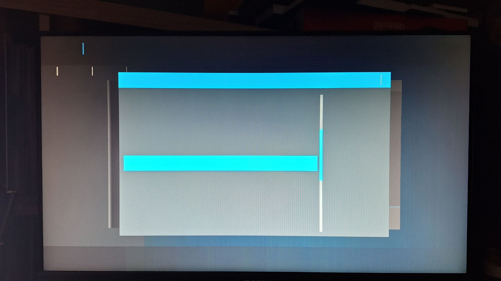

    Unfortunately my PI4 broke down when I was about to get my LibreELEC / Kodi to work perfectly. I have now got a PI5 / 8 GB (the PI is in an Argon ONE V3 and other systems should also run on it - separately).
    Unfortunately I have the following problem after booting - this screen is displayed (1st image). Something happens when you press a button - but nothing "recognizable" is displayed (2nd image).

  • Your RPi5 has new graphics hardware, which isn't supported at LE 12.0.1:

  • The image in post #1 is 100% the mesa issue resolved in nightlies so unless you've mixed up SD cards and are still booting the 12.0.1 image and not the LE12 or LE13 nightly, there's no real explanation. The nightlies work for other users with boards using the newer chip stepping.
    You can add "ssh" to boot params in the cmdline.txt file on the SD card and this will force the SSH daemon to start so you can login to poke around and generate logs. You can also access the "Logfiles" SMB share over the network to generate a zip file in the share with all the logs, but if you are still seeing the same image as shown in post #1 there probably won't be anything useful as systems are up/working okay - only the mesa version is missing support for the newer chip stepping and doesn't render things correctly.
  • I have to apologize now - the nightly worked on the second attempt and I am in the (recognizable) KODI configuration menu.
    Thanks for the help - in my opinion the thread can be closed. If I have further problems, I will create a new thread with the logs.
