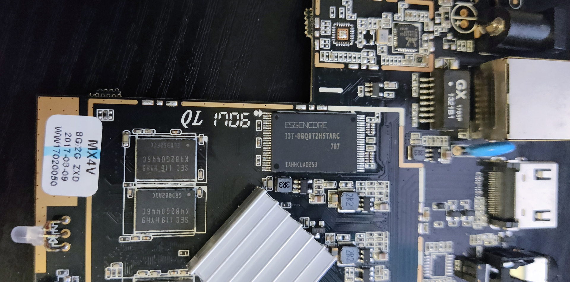

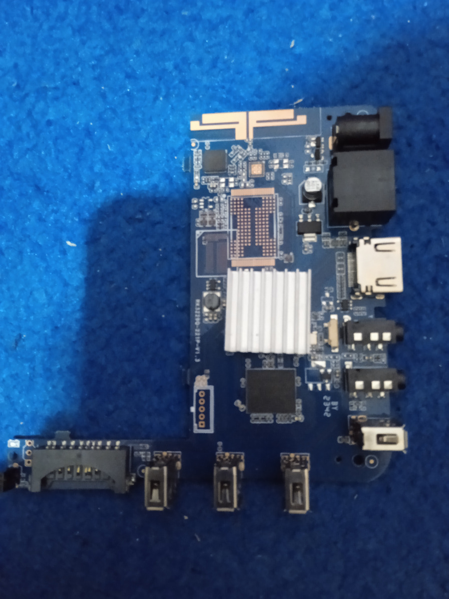

    And here is the picture of the upper side of the board.
    Thanx

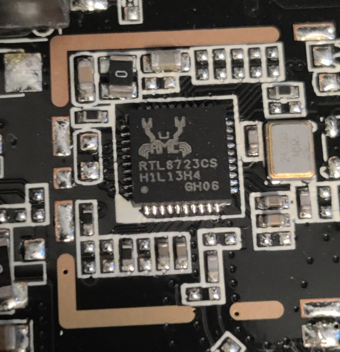

  • There is only one "small" problem called wifi... Wifi works fine with armbian but shows no signs of life in libreelec (using generic image, I don't think others will work). Wifi adapter is Realtek 8723CS.
    Is it possible to include this driver in your next build?
    Thanks

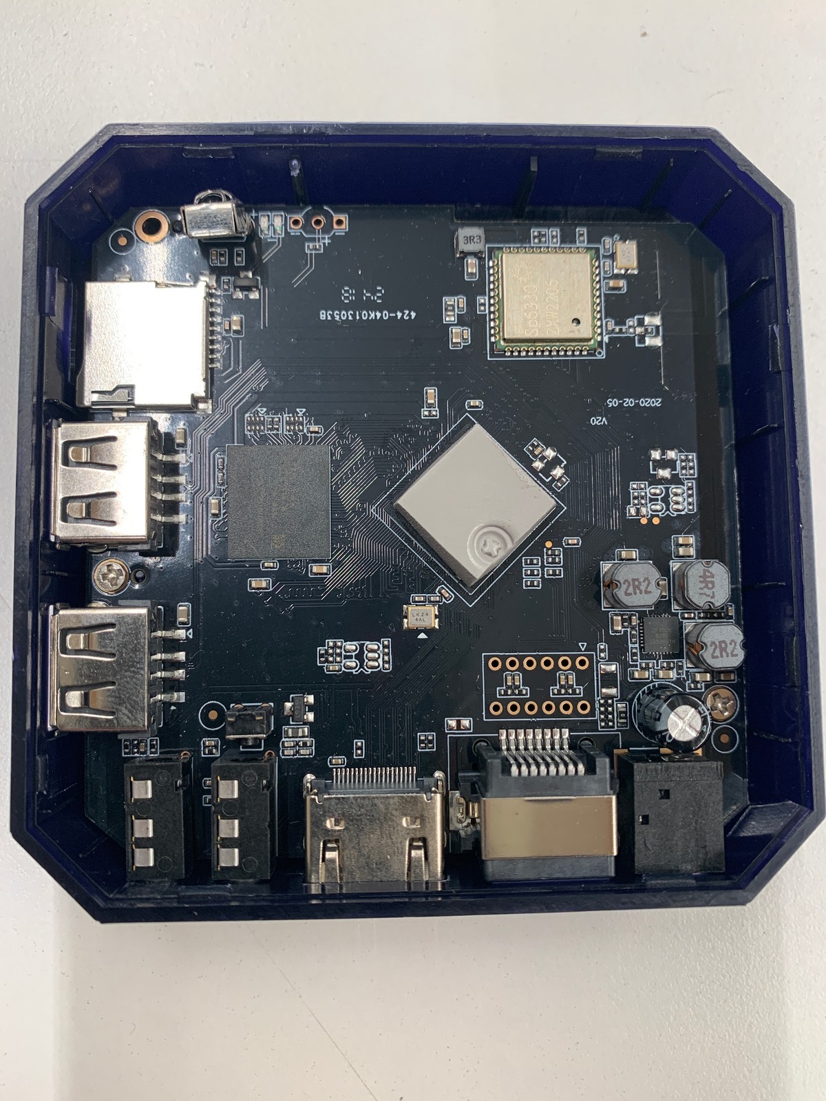

  • leap123 can you understand if we are talking more or less about the same board? (You may have to open the device). Unfortunately, I don't have all the boards, but I remember that pocng had solved it. If so, I'll try to do the fix you suggested
    Almost forgot but here's the board that you're talking about. The specs say it uses a Rockchip RK3228 CPU (or at least I assume it is since it doesn't seem to boot with an RK3229 device tree) and has 1 GB of RAM and 8 GB of eMMC so I'm assuming this is the same board that you're talking about.

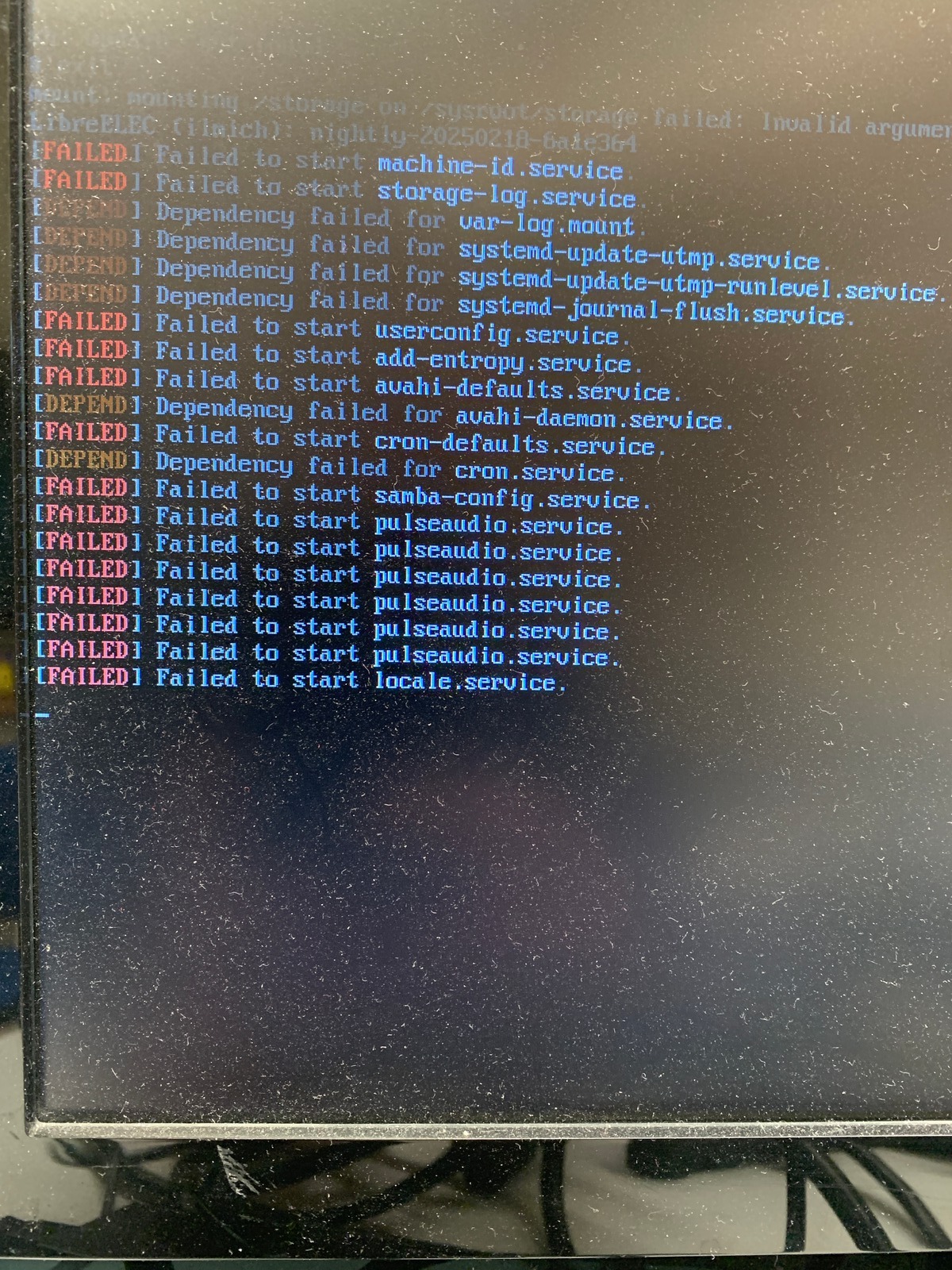

  • I have a G96mini tv box with rk3228 2GB16GB. I tried to use the image: LibreELEC-RK322X.arm-12.0-nightly-20250218-6a1e364-rk322x.img, but it crashes when trying to do /storage_mount
    Hi, just wondering have you tried the 20240914 version from the archive folder?
  • Hi, sorry for the absence. My life has changed recently (my little star was born <3), so my time has been reduced. But I don't intend to abandon this project, I'll just go slower.
    supergigi73 Are you trying to boot from the SD card? If so, how did you prepare it? The error is very strange because it stopped during the storage mount phase, which presupposes that the hardware side has detected everything. Maybe it had a problem when it tried to resize the data partition at the first boot, and consequently, then cannot use it correctly. In any case, if you have a copy of the original firmware (or a link where you can download it, I'll take a look)
    leap123 Unfortunately, since I don't have the board, I can't, as I never managed to do in the past, verify what happens. In any case, with libreelec-13, I'll switch to a hybrid bootloader (some proprietary blobs and mainline U-Boot, a bit like Armbian), where that board seems to work fine. You have to be patient.
