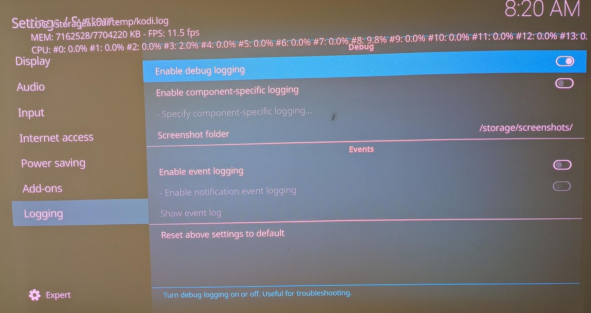

Please provide a full debug log.
How to post a log (wiki)
1. Enable debugging in Settings>System Settings>Logging
2. Restart Kodi
3. Replicate the problem
4. Generate a log URL (do not post/upload logs to the forum)
use "Settings > LibreELEC > System > Paste system logs" or run "pastekodi" over SSH, then post the URL link -

I asked for the debug log because it will show what resolutions and refresh rates are being advertised, and then we can either see what the issue is and/or advise how to set things up. There are no config.txt or dtoverlay things for x86_64 hardware, that's a Raspberry Pi only thing. The 4K-HDR wiki article advice still generally applies.
Okay .. got it working now after disable-reboot-enable-reboot

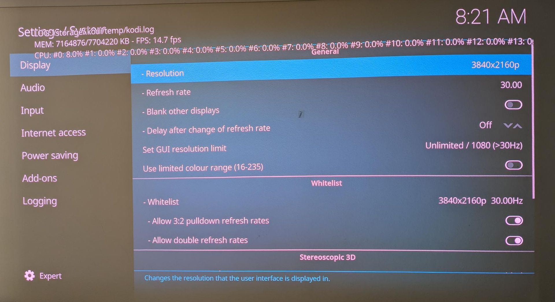

https://paste.libreelec.tv/sure-possum.log
No picture during 4K video playback, but the sound works going from LE across HDMI to AVR pass-through.
1080p content plays back normally, without changing any "Display" settings (i.e. still set to 3840x2160p @ 30Hz)
The log and screenshots show that you forced the desktop to 4K@30 and there is a single whitelist entry for 4K@30 .. which means you're attempting to force all media to play at 4K@30 resolution with Kodi upscaling everything itself. It's a recent i7 CPU with 16x cores so it has some grunt, but media apps aren't as multi-threaded as you might assume, so regardless of the specs that might not work, and processing e.g. 4K@23.976 media (most movies) to 4K@30 requires a lot of compute. The log doesn't show any playback, so hard to comment on what goes wrong, but..
I'd recommend setting the desktop to 1080p and then whitelisting 4K@30/29.97/25/24/23.976 and 1080@60/59.94/50/24/23.976 and allowing mode doubling (hence 1080@25/29.97 are not required). That should allow Kodi to switch 1080/4K to native resolutions as needed, and the only stuff that won't be handled is 4K@60/59.94/50 which requires HDMI 2.0a capabilities in the AVR/Projector.
All suggestions long documented in here: https://wiki.libreelec.tv/configuration/4k-hdr
