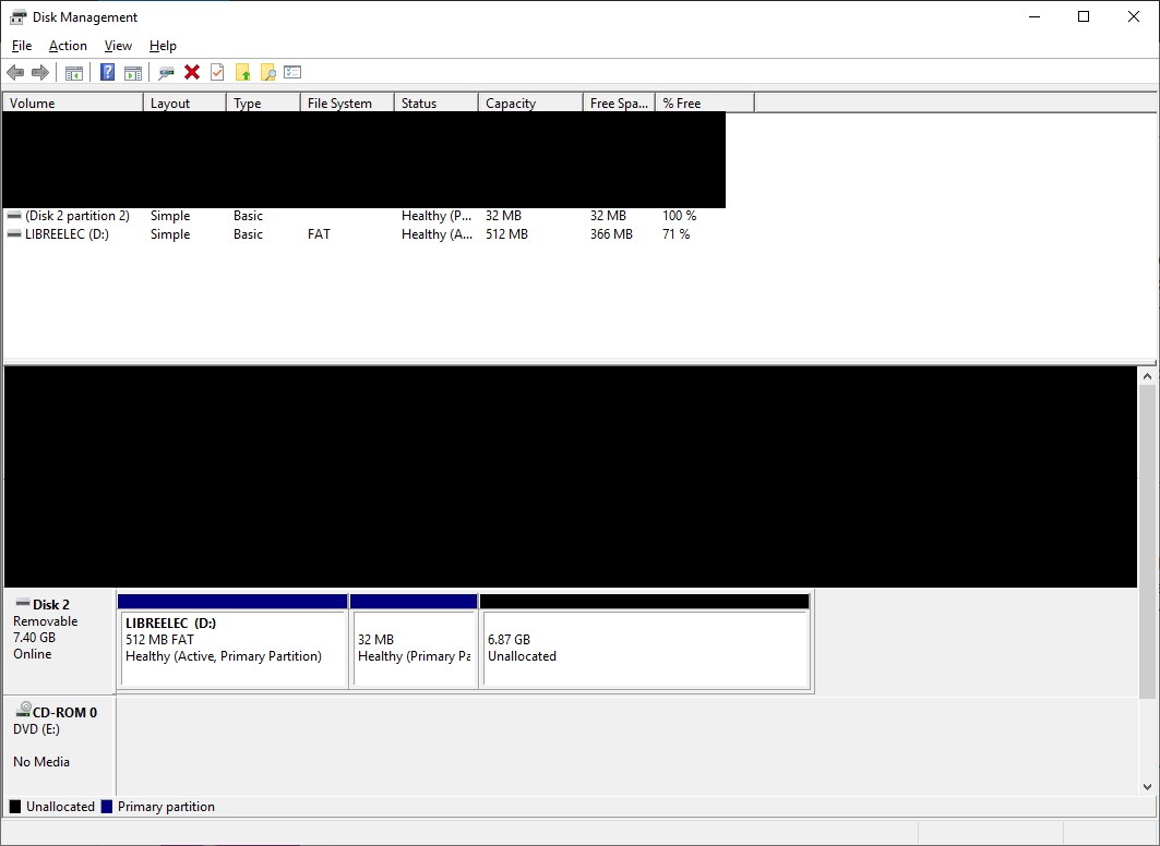

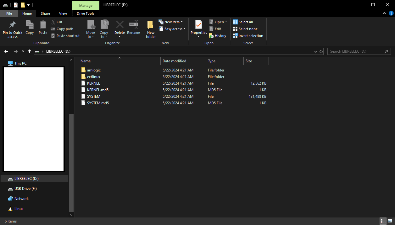

See if https://chewitt.libreelec.tv/testing/LibreE…droid-c2.img.gz boots for you (it does for me). Please ensure the boot partition of the SD card is readable, i.e. prove you have correctly written the SD card and not just put the file on an SD card or direct-wrote the compressed image to the hardware (needs to be uncompressed). Do not rename files in the root folder of the SD card as done with some legacy images else it will break boot.

Ok. So, I used the 8gb micro-sd card that I was running on before, and flashed it with the link you provided above. I used balenaEtcher to write it this time instead of the LibreELEC creator app.
I have an SD to micro-SD interface and then a USB to SD device. I have used this in the past, including this morning to write a pfSense image to another micro-SD card that booted fine on my router/firewall (upgrading to 2.7.2, but that's another story).
When I put the card in the reader, I can see 2 partitions:
I am also able to view the LIBREELEC partition and can open files:
Same behavior as before. I plug power in, the red light turns on, no blue light, and after a few seconds the network jack lights start to blink.

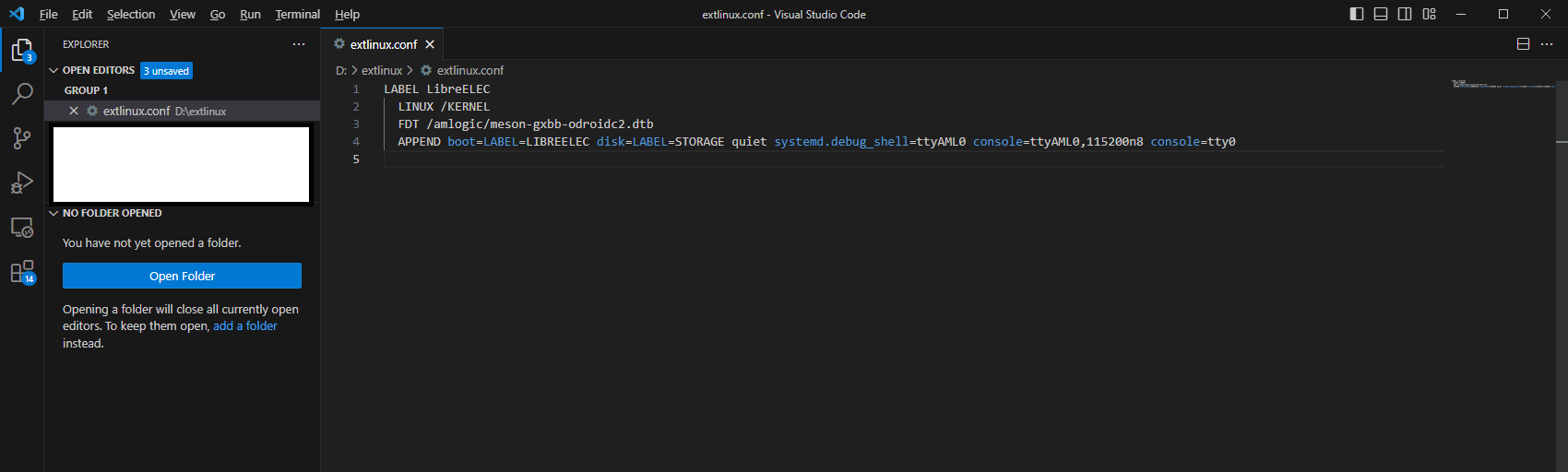

That comment ^ suggests the board is booting, because network LEDs blink because code tells them to, not magic. If you add "ssh" to boot params in extlinux.conf it will force the SSH daemon to start, allowing you to login over the network with an Ethernet cable connected to see what's happening. If you add "video=HDMI-A-1:1920x1080M@60" to boot params it will force the kernel to output 1080@60 on the HDMI connector, in case there's something odd with HDMI cables and the monitor. It's not a cure-all for an HDMI issue, but you'll have a screen to look at, maybe. Perhaps connect to a proper TV instead of a monitor?

So my /extlinux/extlinux.conf file looks like this:
CodeLABEL LibreELEC LINUX /KERNEL FDT /amlogic/meson-gxbb-odroidc2.dtb APPEND boot=LABEL=LIBREELEC disk=LABEL=STORAGE ssh quiet systemd.debug_shell=ttyAML0 console=ttyAML0,115200n8 console=tty0 video=HDMI-A-1:1920x1080M@60I plugged it in. Blue light never comes on. Network lights come on after a few seconds. Mainly orange one, but orange and green will come on periodically. No output to display.
