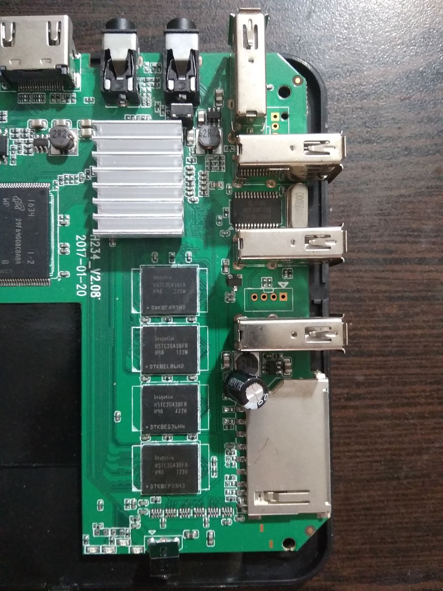

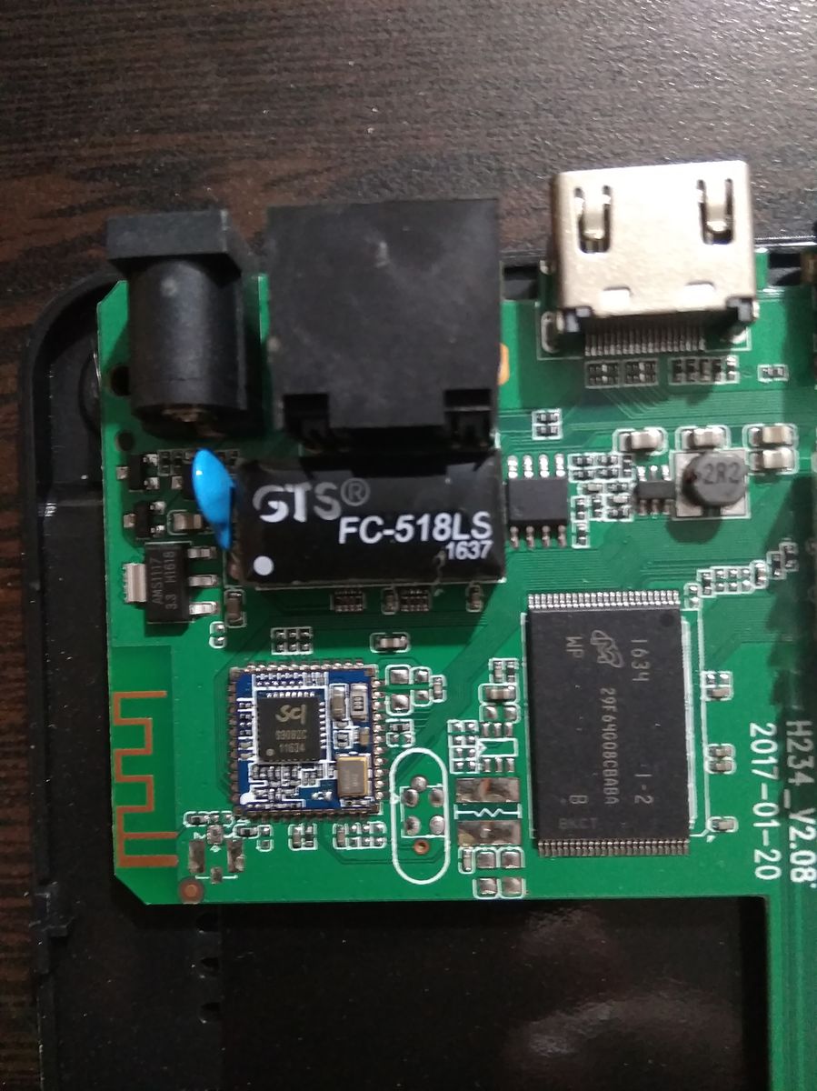

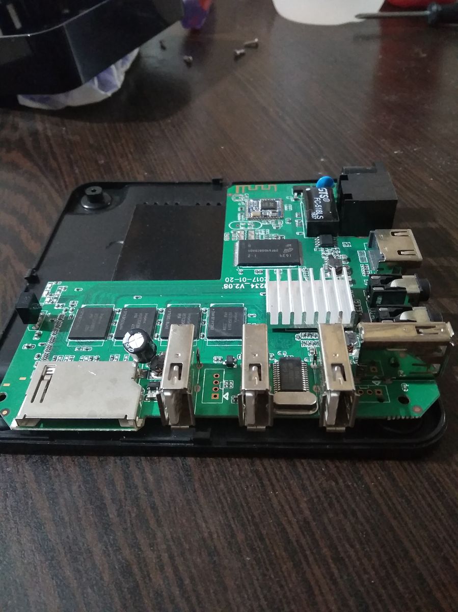

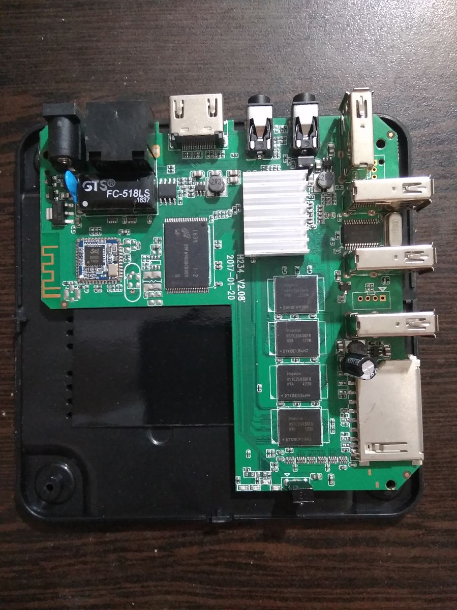

April 6, 2024 at 2:13 PM New #1 helloI want to install libreelec on this board but I don'tknow which one is compatible with this board.I would appreciate your help.amlogic s905x1gb
April 7, 2024 at 9:23 AM New Best Answer #2 You should be able to use the "box" image with the p212 device-tree, read: https://wiki.libreelec.tv/hardware/amlogicNB: There are no drivers (that work on upstream kernels) that exist for the WiFi chipset in the box.
