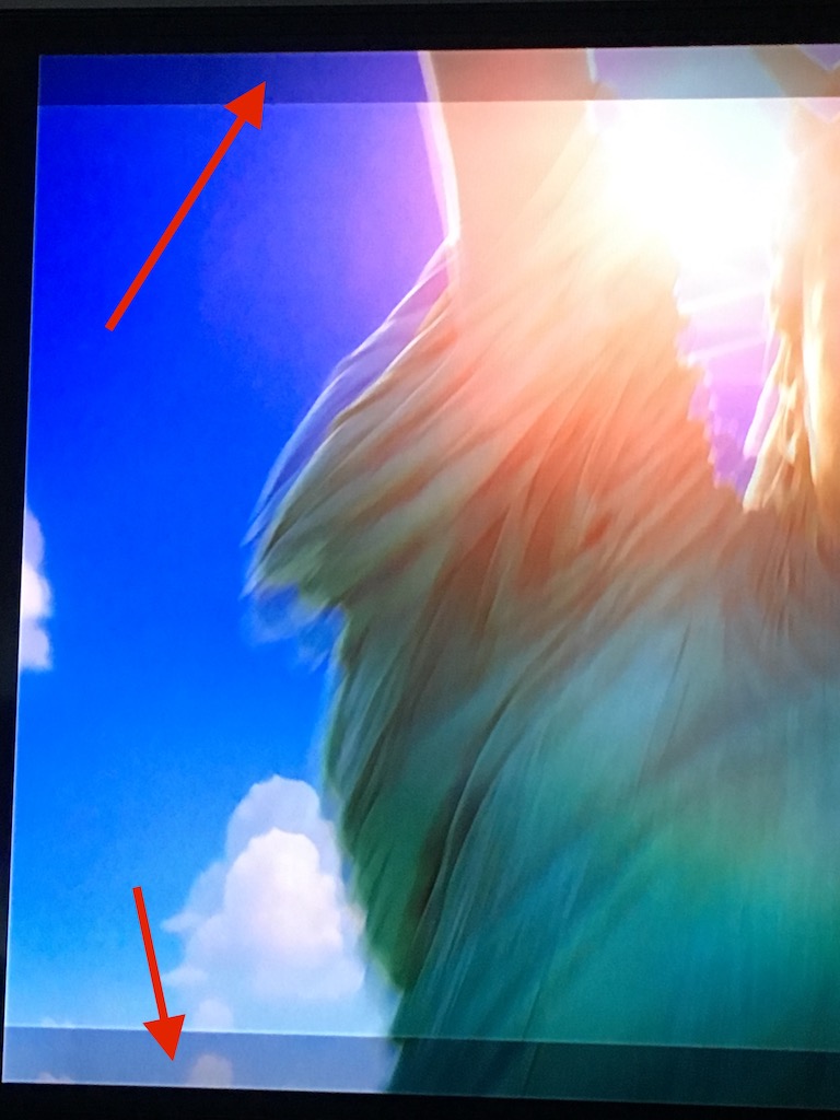

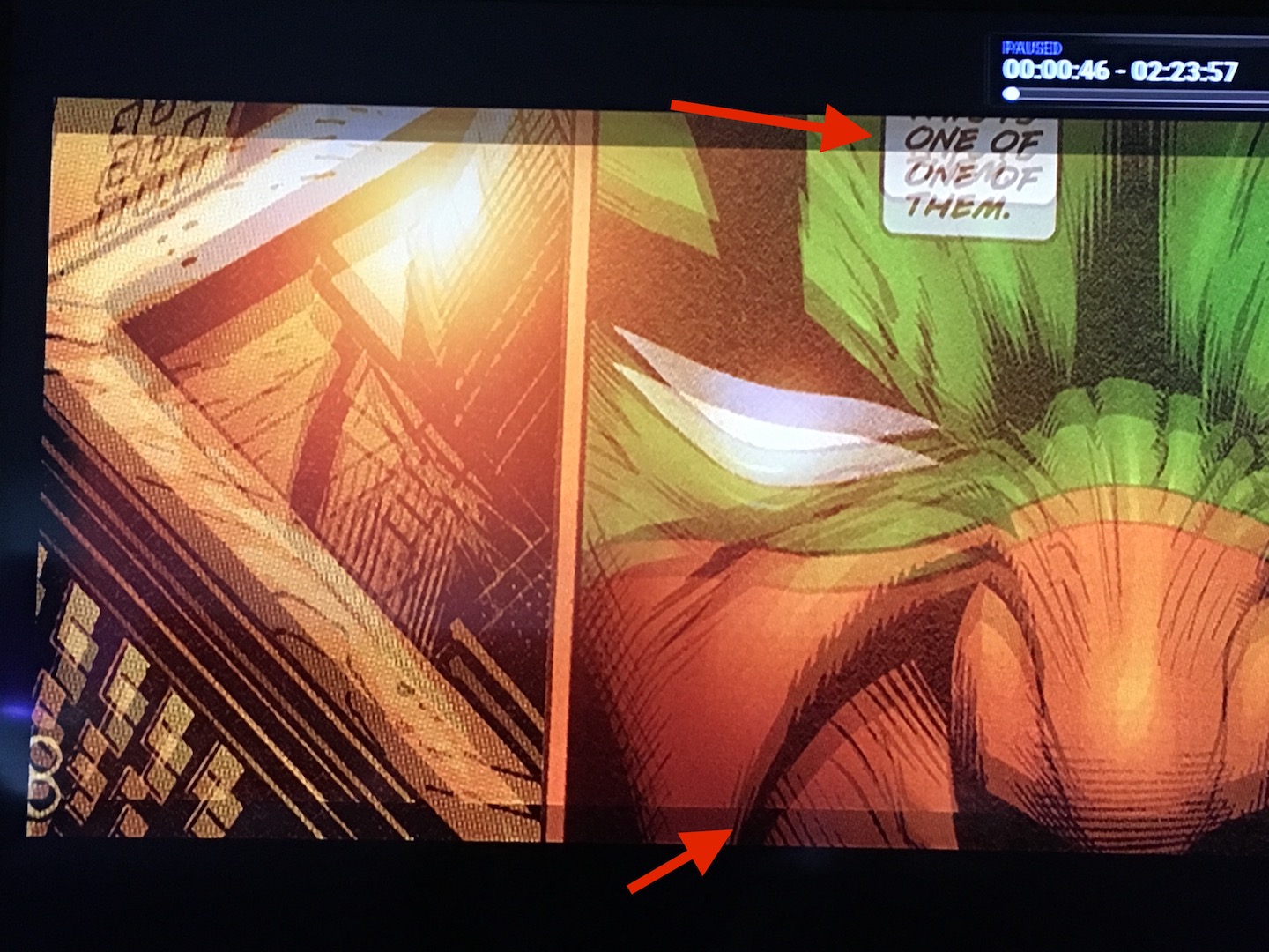

    - When starting a 3D bluray.iso (tested with self-ripped movies: pets, startrek beyond and turtles - full menu) LibreELEC says "3D disabled" and starts the movie as Over-Under.
    - then switching the TV seperately to 3D (ou) the upper and lower pictures doen't match in alignment. (see screens)
    So far I can tell, is that LibreELEC doens't recognize the source-material to be 3D, because the menu get's "split" in TV 3D_over/under mode.
    Tested other 3D over/under movies (.mkv) --> all work fine ! Don't have the ability to test another 3D TV :(
    Both boxes (the s905 & s905x) show this issue.

  • UPDATE:
    - tested it with other TVs (Panasonic 4k / Samsung fullHD) -- same effect / bug !
    - tested it with other 3D movie files and found something NEW!
    • I loaded up a "movie_3d.mkv" which was 1080p side-by-side.
    • LibreElec detected it was 3D (however it did it)
    • same effect on SBS movies !
    • ==> the RIGHT & LEFT borders are not aligned properly.
    When playing the "movie_3d.mkv" with my TV's built-in Mediaplayer it works fine : so it's rather a software bug, I guess ?!
