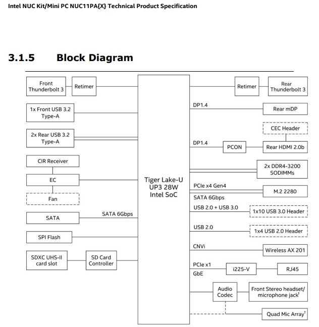

  • Probably an (LS)PCON chip issue:
    smp
    January 15, 2024 at 2:36 AM

  • I suspected as much. Just seemed odd that 7.1 LPCM works fine (but not HD audio bitstreams).
