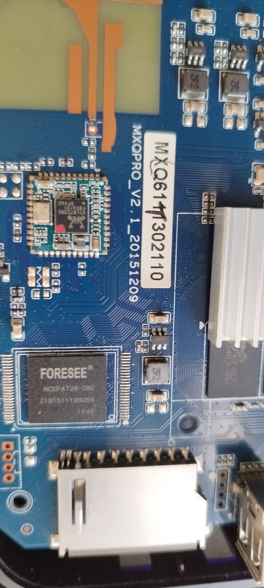

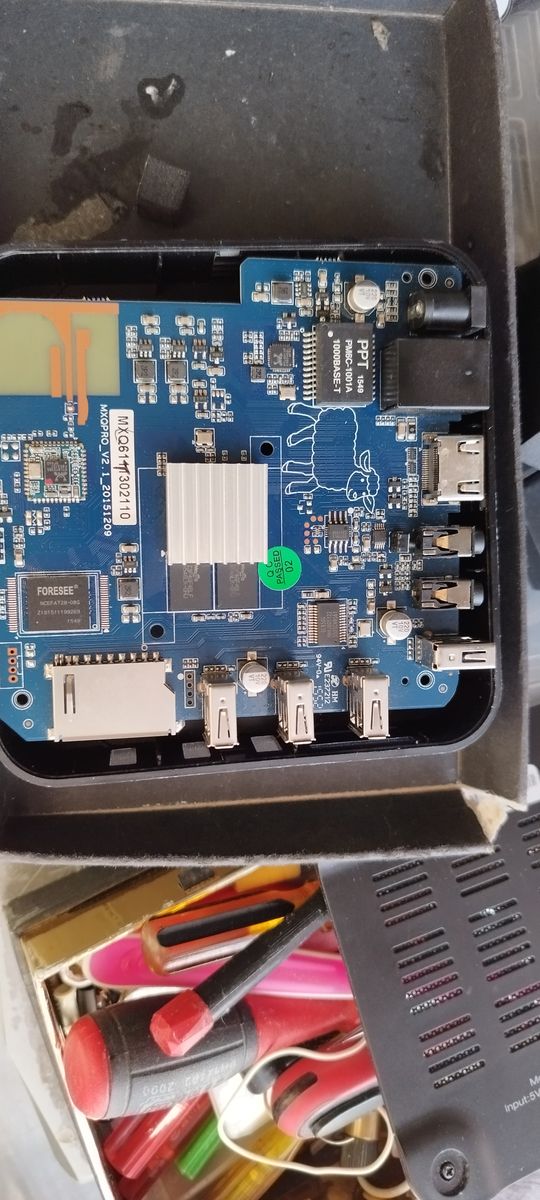

There are many generations of "MXQ" devices from hundreds of manufacturers. What SoC/Chip is inside the box?

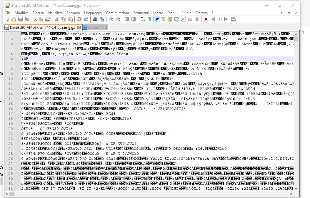

I cant find uenv.ini file...please help.
Regards
Dude, you are looking at a compressed image. ![]()
Decompress it, and mount that image to look inside.

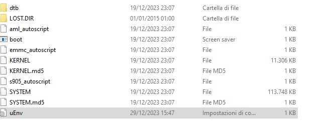

Create the SD card first, then the files are just sat there in the boot partition.
usb created, file uenv.ini modified... can not install nothing is happening all meson 200-201tested
