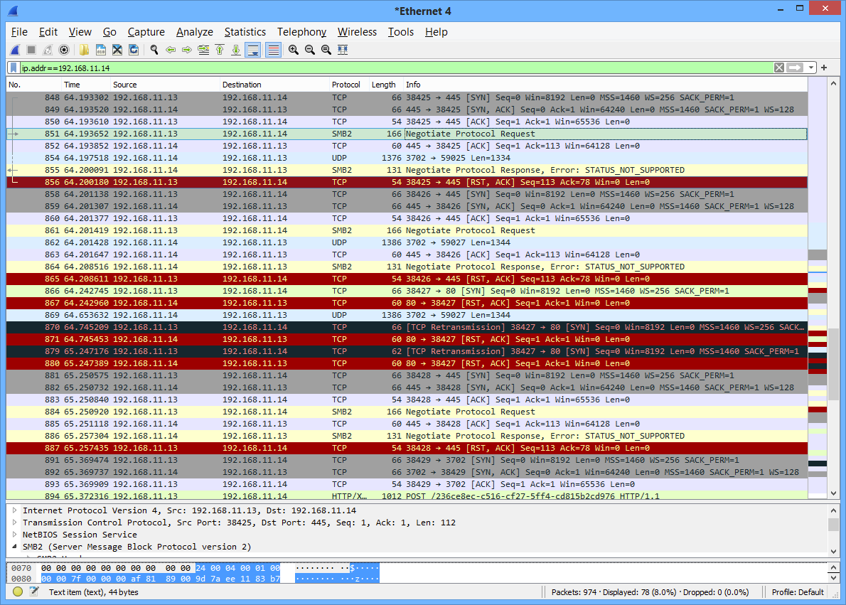

    Here's a WireShark capture on the PC; .13 is the PC, .14 the LE Pi:
    I don't know enough about SMB to understand if those errors are critical.
    Thanks!
  • The SMB "Client" config in Kodi settings has nothing to do with the Samba "Server" which can be enabled (on/off and the password changed) in the LE settings add-on. The default Samba config can be overriden by renaming samba.conf.sample to samba.conf and editing to include whatever changes you want then reboot to effect the change. If no custom config is present it boots using a default config that supports SMB2 and SMB3 and unless you force different behaviour via registry tweaks Windows clients will connect at SMB v2 and then negotiate up to v3 if the server supports them. The Wireshark trace shows the client device connecting and then trying to negotiate an SMB2 connection which fails with the server issuing a STATUS_NOT_SUPPORTED response. I've no idea why that happens and you proved the server is running and can be browsed from the Linux device.

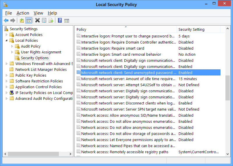

  • Control Panel > Administrative Tools > Local Security Policy > Enable - Microsoft Network Client: send unencrypted password to third party SMB servers. When asked for credentials use "servername\username" format.
    ^ Guessing based on some Google searching. Win8.1 license keys should be eligible for a free Win10 or Win11 upgrade and from a security, usability and compatibility perspective it would be a good move.
  • Thank you... here's a screenshot of where that is:
    I guess I'll have to reboot the PC, as it's not working yet...

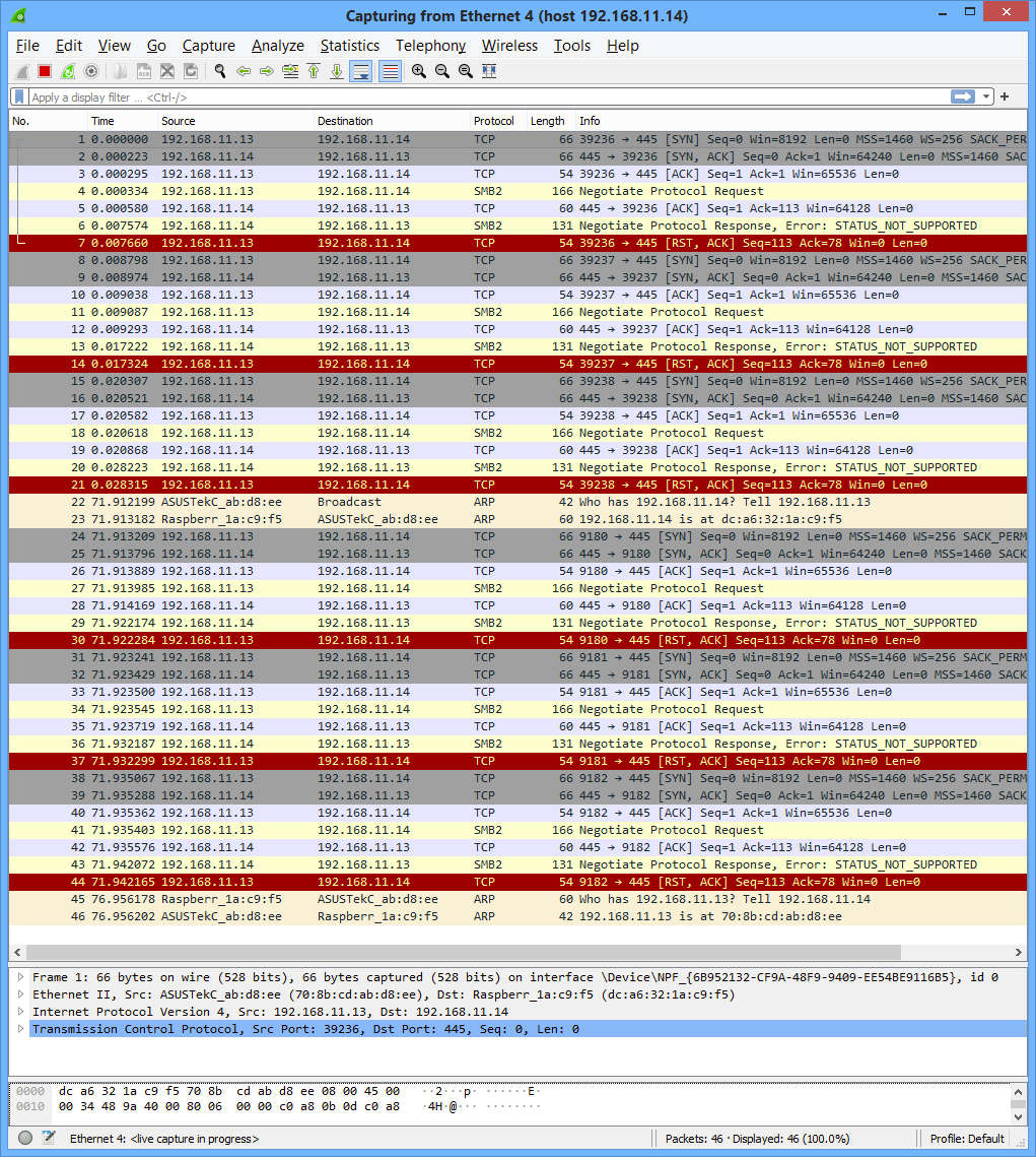

    Unfortunately, that didn't help. Wireshark capture still looks similar:
    Thanks for your help!
    Edited once, last by barry: Merged a post created by barry into this post. (November 4, 2023 at 5:33 AM).
  • The devices clearly connect so it's a likely a protocol issue and one of the challenges with old Windows (WinXP/7/8) these days is changes to crypto. Have a play with the other 'client' options in the local security policy list too (and yes, reboot required, it's Windows).
