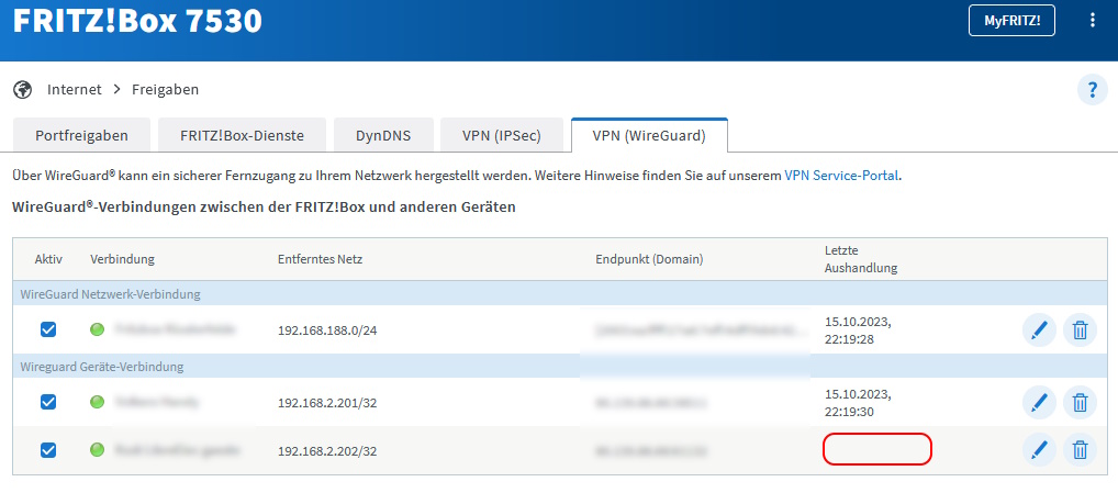

  • This sounds very similar to the behavior which I observe with my Wireguard VPN server hosted on my Fritzbox.
    Connections work 100% reliable when connecting other networks via Fritzbox or clients eg from my Android mobile device.
    When connecting from LE on my Raspberry PI 3, the connection is reported to be established.
    However, the connections is available only sporadically.
    Using ping, I see that for 80% of the connection attempts, the connection is not available. Sometimes ping works after establishing the connection. But only for a limited time. After less than 5 minutes (exact timing is random) ping stops working, and never recovers afterwards.
    Checking the connection on LE using "wg" command, the connection is reported as established, even though the connection obviously dropped.
    In the Fritzbox connection details the connection sometimes even gets a green checkmark.
    However, in contrast to the working connections, the LE connection never receives a timestamp in the "last negotiation" column:

  • After playing around a bit, I think that I have found the reason for that behavior. I used my VPN server's (public) hostname (fqdn) instead of it's public IP address. Using an IP makes the VPN connection work.
    Great that it works that way but using an dynamic public IP (which can change from time to time) is not a great solution as you have to check and manually edit those config files again on every IP change.
    Is that really so, that this wireshark implementation cannot handle hostnames (fqdn) and must use IPs instead?
  • WireGuard requires the host (server) to be an IP address and ConnMan does not implement logic to resolve an FQDN to an IP before configuring the WireGuard interface and bringing it up, or perform periodic validation of an FQDN to detect IP changes.
    It's not an impossible problem to resolve [sic]. Create a script that resolves the FQDN against a trusted upstream DNS server (not a local one which caches results) and compares the IP to the current WireGuard conf IP, and if different, sed the value in the conf and then restart the WireGuard service to recreate the connection with new values. Use cron or a systemd timer (which is cron) to run the script at periodic intervals.
  • I can confirm that the problem I had posted above (Wireguard with Fritzbox host) works when I switch the config to an IP instead of a FQDN.
    I think this limitation could be highlighted a bit more prominently in the wiki page. Yes, the wiki mentions only an IP address. However, by default one could assume that it could be easily replaced with an hostname. Adding one sentence to the known issue chapter stops people like me from going into the wrong direction. A direction which is well possible to take as VPN and Dyndns is a very common combination for many use-cases. (For me, I use it to connect to my tvheadend instance at home when travelling.)
