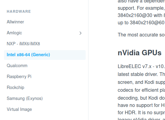

  • Are you using the Generic Legacy image? The default (GBM) Generic image no longer contains nVidia drivers due to their lack of support for modern Linux graphics standards.
  • The default (GBM) Generic image no longer contains nVidia drivers due to their lack of support for modern Linux graphics standards.
    Does this mean, that nvidia graphic card is no longer a good choice?
