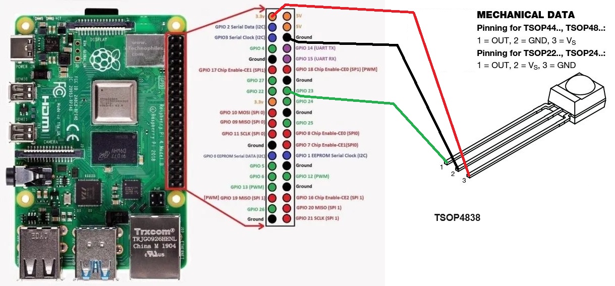

- TSOP in my case was connected to GPIO pin 23, so following line needs to be added to config.txt (you can edit it directly on the SD card):
dtoverlay=gpio-ir,gpio_pin=23

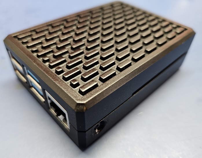

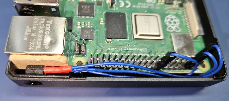

That's it, pretty simple. Attached few pictures from my setup, I used alu fanless cooling case and drilled hole in it to expose the sensor.
