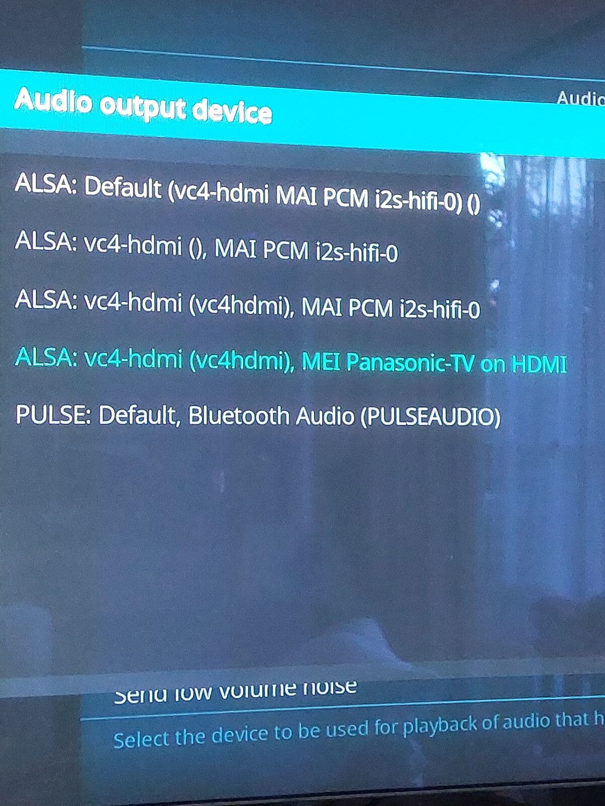

  • hi there,
    Im using a rpi3
    My os is LE10 (kodi 19.5)
    I have an extra soundcard hifiberry+ but I dont know how to configure the spdif output.
    It doesnt appear in the sound settings of kodi...
    Only appears alsa defaut hdmi (4 times) and pulse default bluetooth.
    See enclosed a picture
    Any idea to force the spdif output of my hifiberry+?
    I bought a hdmi splitter to spdif but it doesnt work either...
    Thanks in advance

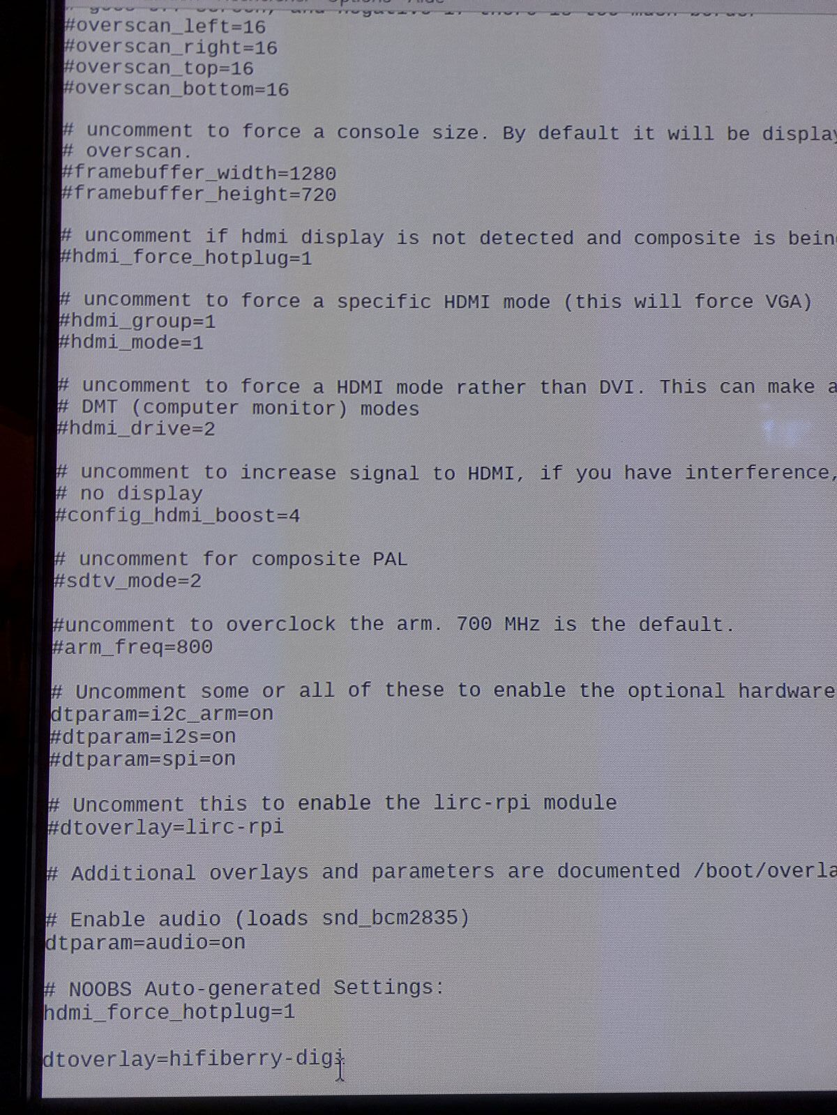

  • Da Flex
    Thanks for your help.
    dtoverlay=hifiberry-digi is already in config.txt but it doesnt help...
    The only audio settings I can choose are hdmi and audio pulse bluetooth.
    See picture enclosed.
    Im desperate...
    Thanks in advance
  • hello Da flex,
    I deleted the lines
    • dtparam=i2c_arm=on
    • dtparam=audio=on
    • hdmi_force_hotplug=1
    But it didnt work out
    Then I downgraded L10 to LE9 2.8 (leia 18.5).
    Unfortunately i still dont see hiifidberry in my available audio outputs in kodi...
    Do you have any idea how to force it into config.txt?
    Thanks in advance
  • Kuman SC07C Raspberry Pi HiFi Digi+ with spdif.(Soundcard)
    That package contains the PiFi Digi+ soundcard, not the original HiFiBerry Digi+. So the driver at config.txt doesn't work for you.

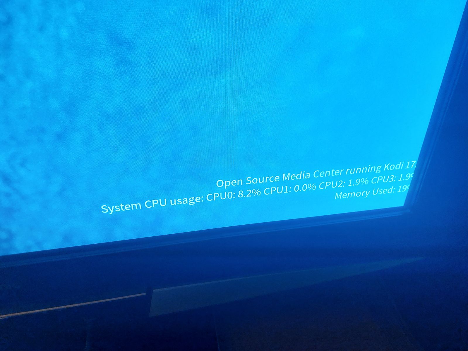

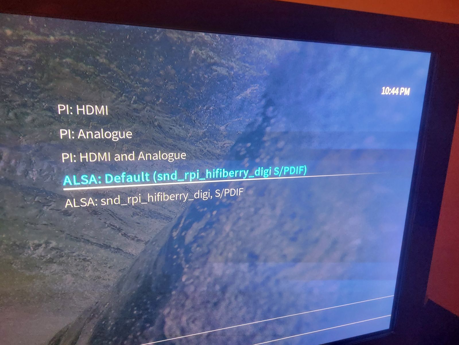

  • Hi Da Flex,
    Im a bit lost as I am a real beginner in here.
    I dont know which instructions you are talking about in Raspberry PI OS.
    I just can tell you that before upgrading LE 9 to LE10, my spdif output was working and available in kodi 18 (leia). When I downgraded from LE10 to LE9 it mystiriously disappeared.
    By the meantime, I still have another kodi 17 installed on my pi.
    This session works with my soundcard in spid. See the picture enclosed...
