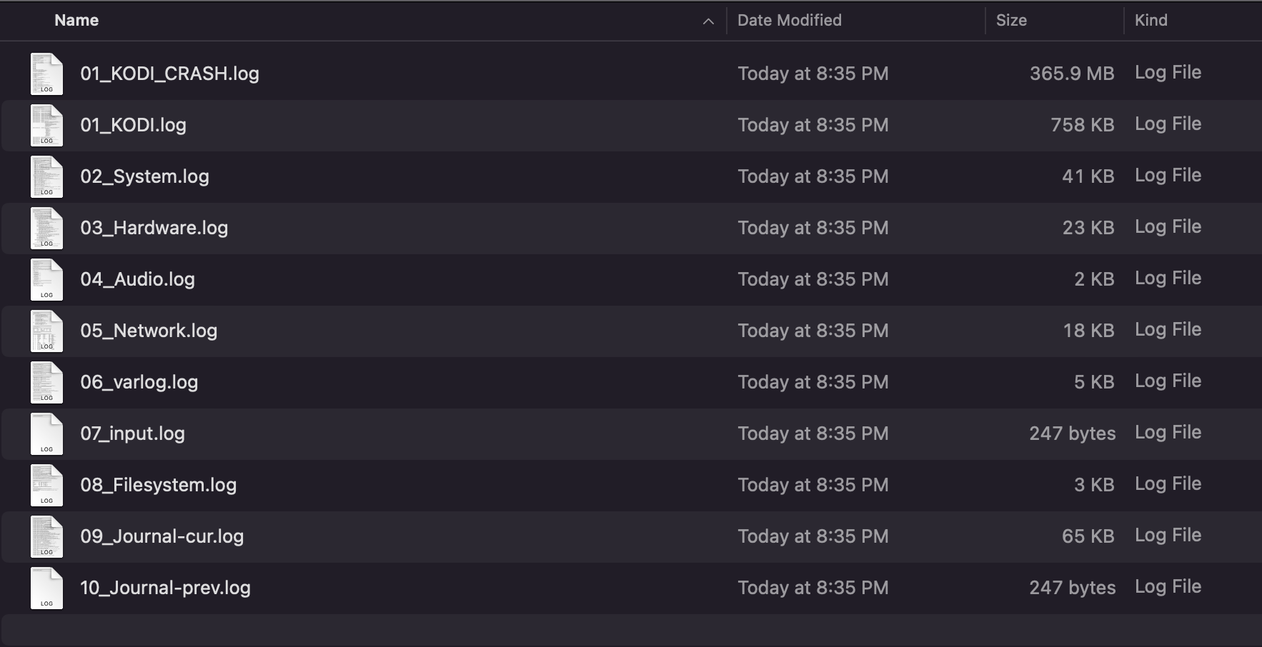

    Perhaps the answer is in the logfiles but there's tons of them I'm not sure what I'm looking for. I'm happy to provide the logs if that helps, just let me know which ones to upload. I thought I remembered last time there was some debug log but I don't see it and I'm not sure how to generate it. Any help is appreciated!
