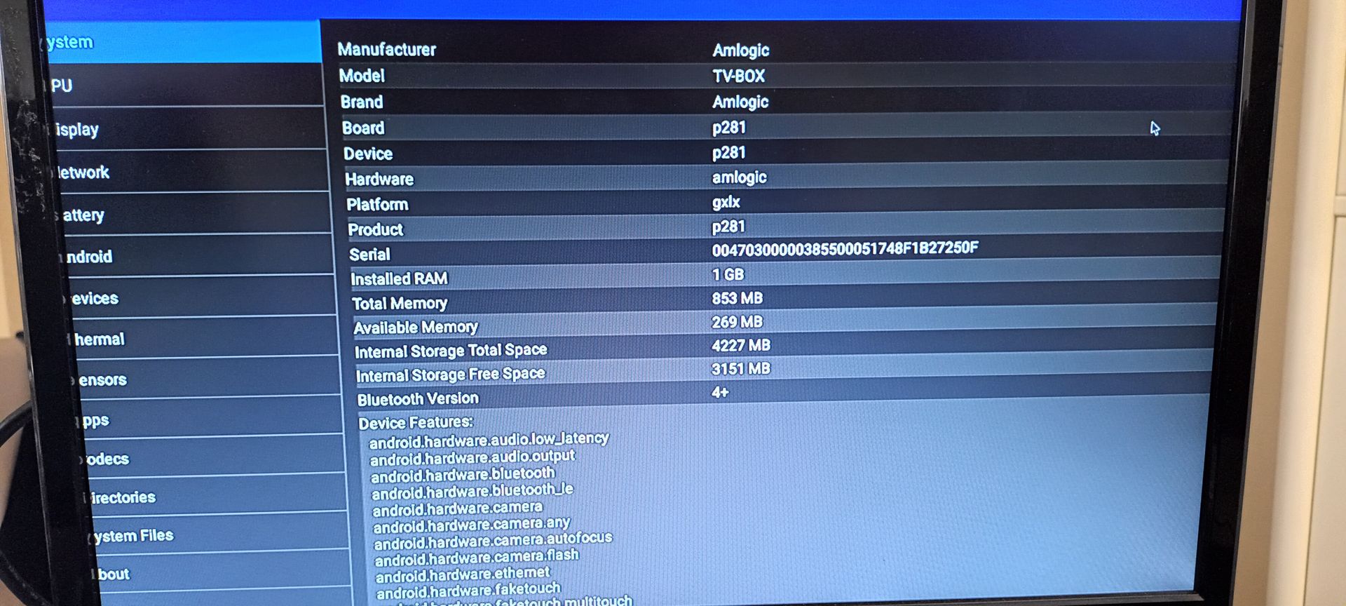

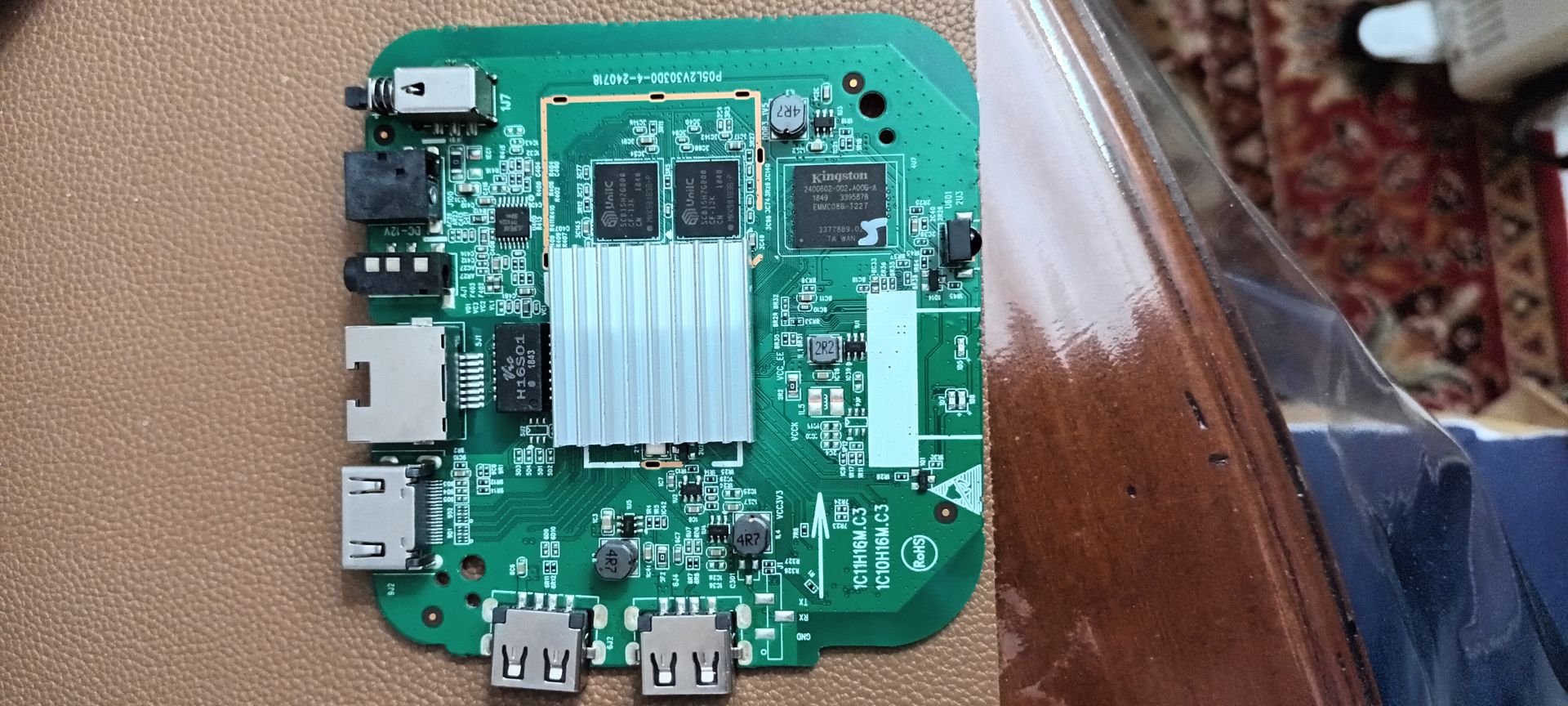

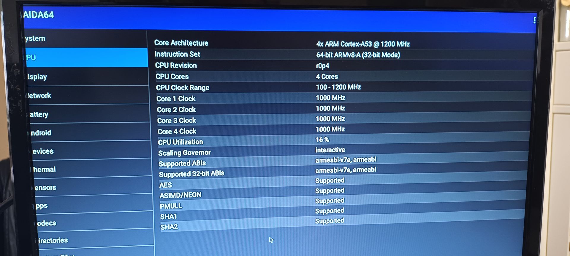

I'm trying to identify this cheap/fake TV box in order to install libreELEC (I tried a lot of builds unsuccessfully).
Someone knows this box and how to install libreELEC?
Thanks.

Use the AMLGX "box" image with meson-gxl-s905w-p281.dtb or meson-gxl-s905w-tx3-mini.dtb defined in uEnv.ini .. P281 is an S905W, which is a cost-engineered S905X. It will be limited to 1080p in LE.
