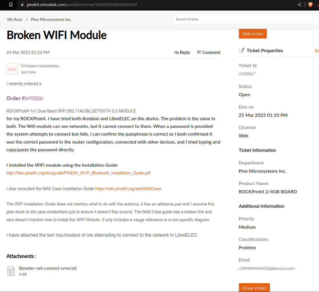

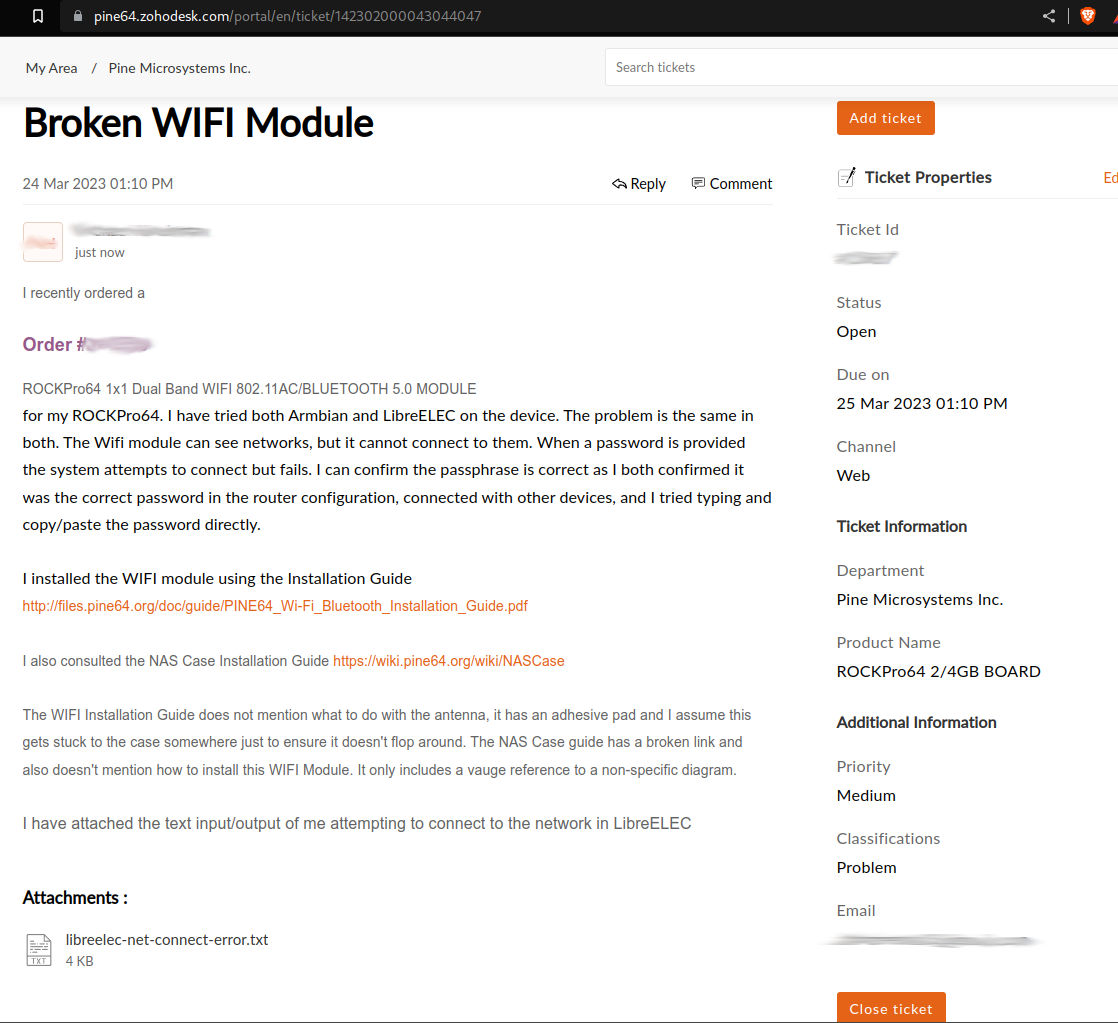

    I have tried it in Armbian and received the same result. I'm suspecting the WIFI Module, or antenna might be the culprit. I've started a ticket with Pine64's support team and will keep y'all updated
  • I have tried it in Armbian and received the same result. I'm suspecting the WIFI Module, or antenna might be the culprit. I've started a ticket with Pine64's support team and will keep y'all updated
