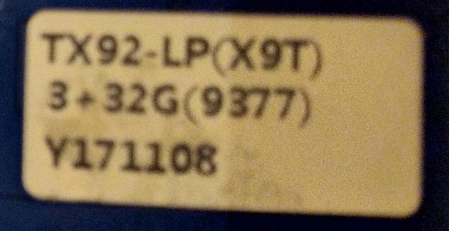

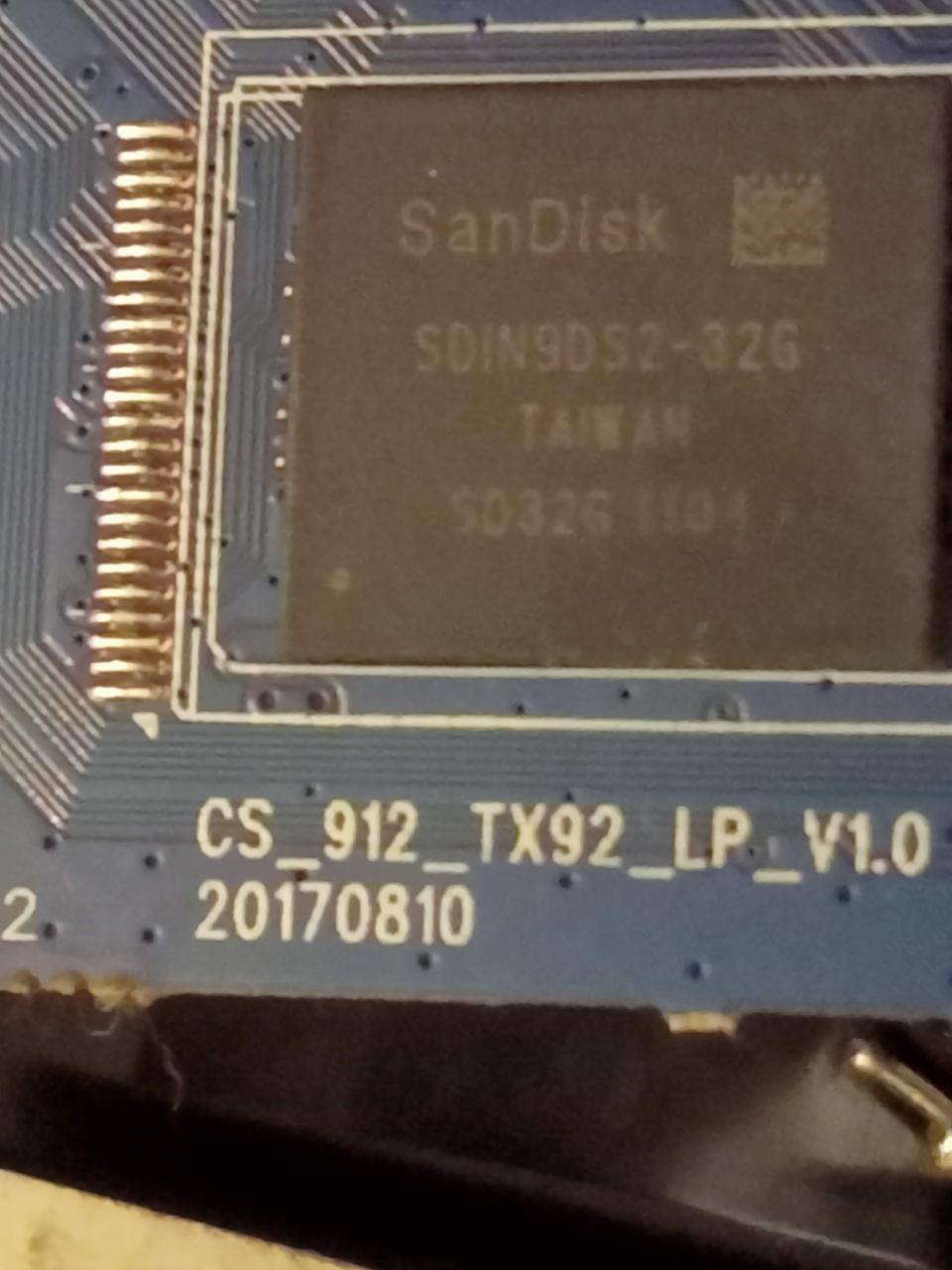

    The vorke z6 plus is clearly a clone of the tanix TX92 (non pro) from this image https://www.techwalls.com/wp-content/upl…anix-tx92-1.jpg
    Marking on my MB : TX92-Lp(X9T)
    3+32G (9377)
    y171108
    and CS_912_TX92_LP_V1.0 (plus the mmc chip SDIN9DS2-32G)
