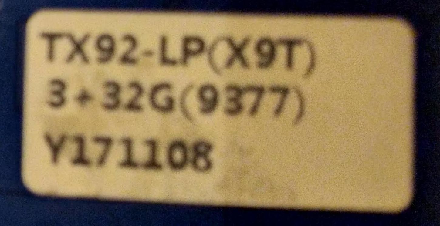

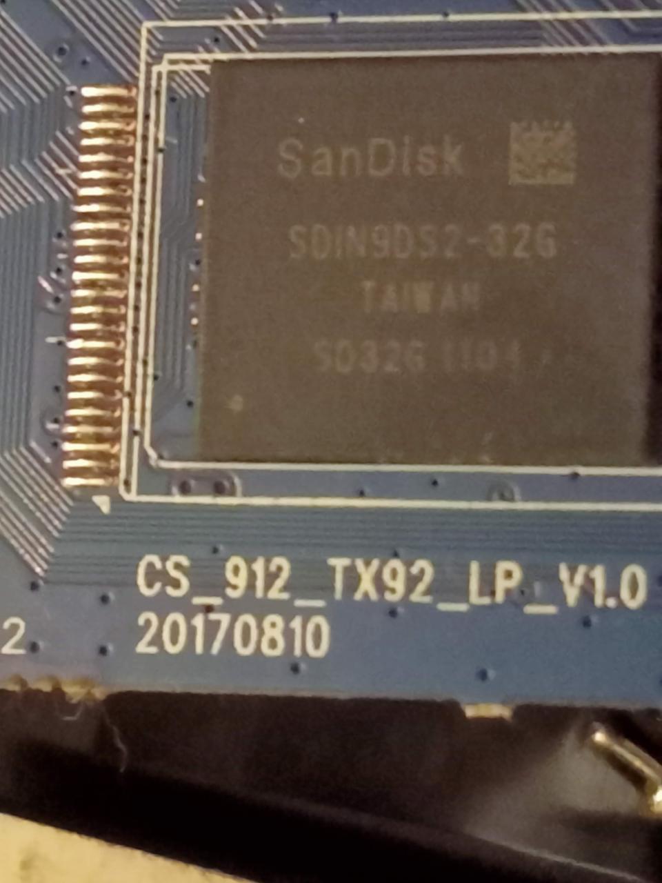

    The vorke z6 plus is clearly a clone of the tanix TX92 (non pro) from this image https://www.techwalls.com/wp-content/upl…anix-tx92-1.jpg
    Marking on my MB : TX92-Lp(X9T)
    3+32G (9377)
    y171108
    and CS_912_TX92_LP_V1.0 (plus the mmc chip SDIN9DS2-32G)

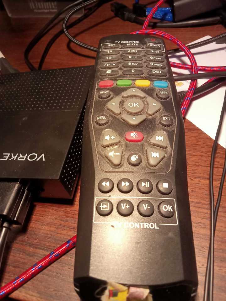

    Hello, chewitt I recognized the remote for PhoenixBG : same as a km8 pro remote :
    the config km8pro.txt should be working but untested by me
    The problem is that there are many configs : the km8 p / pro has the same remote as PhoenixBG has for a T95Z Plus
    but i have a bm8 pro (same box, different remote) that comes with this one :
    this config works in CE ,and also works to power on my vorke z6 plus : kiplus_compl.txt : 0x59 KEY_POWER for NEC driver
