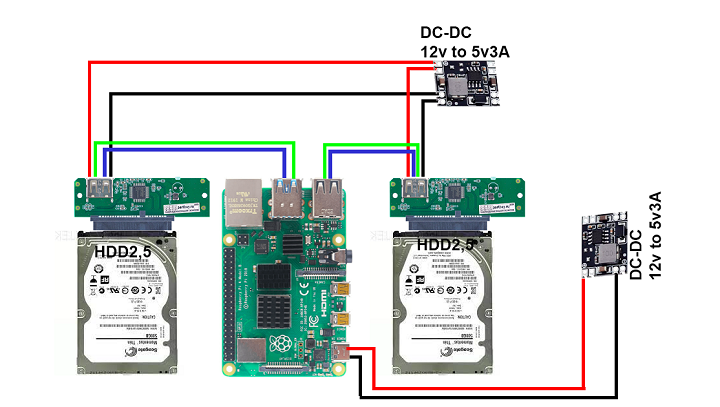

RPI + 2 HDD
Raspberry pi4 reboots intermittently.
To run LibreELEC-RPi4.arm-9.2.8.img
Copied start.elf from LibreELEC-RPi4.arm-11.0-nightly-20220618-b78941a.img
Please, tell me the reason
PS. On RPI3 everything works ok

There's missing ground connection between RPi and top DC-DC converter on the diagram...
I suppose it's done through the common ground wire from a single 12V PSU but if not, it could behave very strange.
Power supply 1 for them 12v8A
It's also important if the wires (including connectors) used are capable enough to transfer power spikes, especially the lowest ground wire on the schema. If this is really the only ground wire, I would avoid using the USB-C power connector and power the RPi from the pins on the large connector instead.
Nevertheless, I think omitting the ground connection between top DC-DC module and RPi is not a good design.
