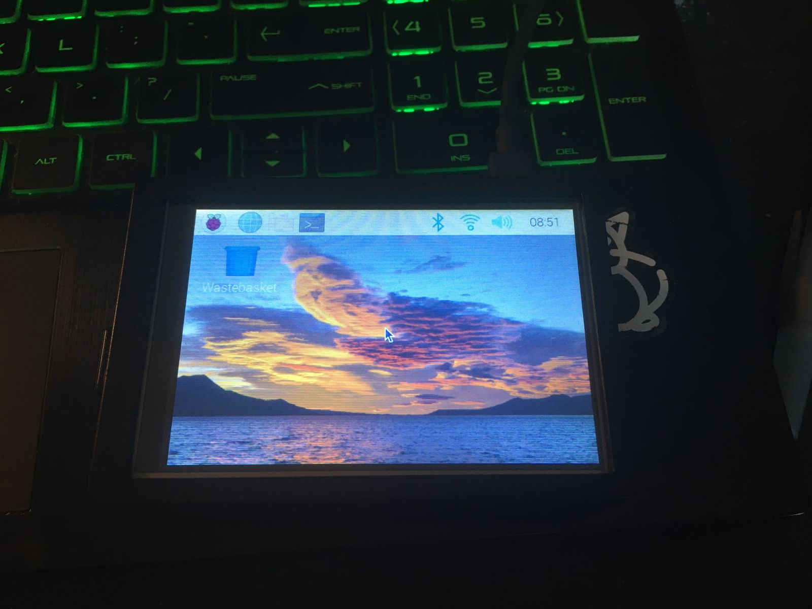

    So you said you want to use this: https://www.ebay.com/itm/155244952918
    yes it came with a card on how to install the drivers but its for Raspbian OS, LCD-show but I want to use LibreELEC with the touchscreen
