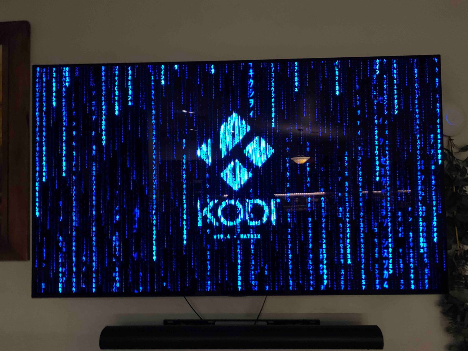

  • I have LE 10.0.3 running on an RPi4 and have been using the same configuration for a few years (updating through various LE versions). I rebooted the RPi4 yesterday and am now stuck on the Kodi screen-- the one that comes after the "LibreElec Just enough OS for Kodi" screen. I attached a picture below so I'm clear. SSH into the RPi4 works, it has an internet connection as measured through response pings to external sites, and it has a proper wireguard connection to a VPN service. I have tried rebooting a few times, and executed a shutdown and power up. Same result, I am at stuck at the Kodi screen.
    Any advice you have for interrogating and/or resolving my situation are gladly appreciated.
