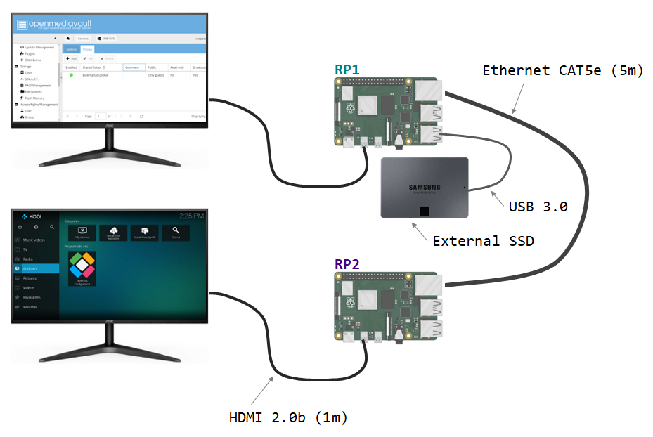

    note that I am using in my question the acronyms RP1 and RP2 which means Raspberry Number 1 and Raspberry Number 2, respectively. Here my question: I would like to stream movies (iso files with a bit rate of around 110Mbit/s) from RP1 (this is my Media Server) to RP2 (this is my Media Player) via direct communication. All my movies are stored on a External SSD which is connected to RP1. See the picture below for a better understanding. What I have to do to run my movies on RP2?
    Thanks in advance and best regards Marco
    Edit: Why I want this setup? The first reason is i do not want all the cables, flashing lights and noises of my HDD's in my living room. Therefore I need Media-Server in the basement room and Media-Player in the living room separate. Furthermore, I guess that a direct communication (without any network switch or router in between) gives me the best performance I need.

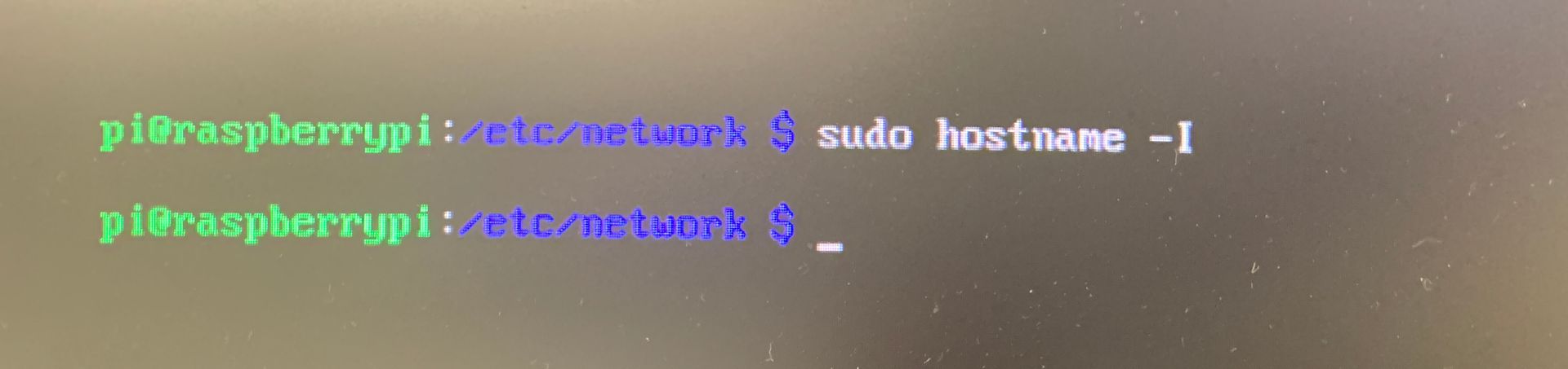

    RP1 {no IP address configured}:

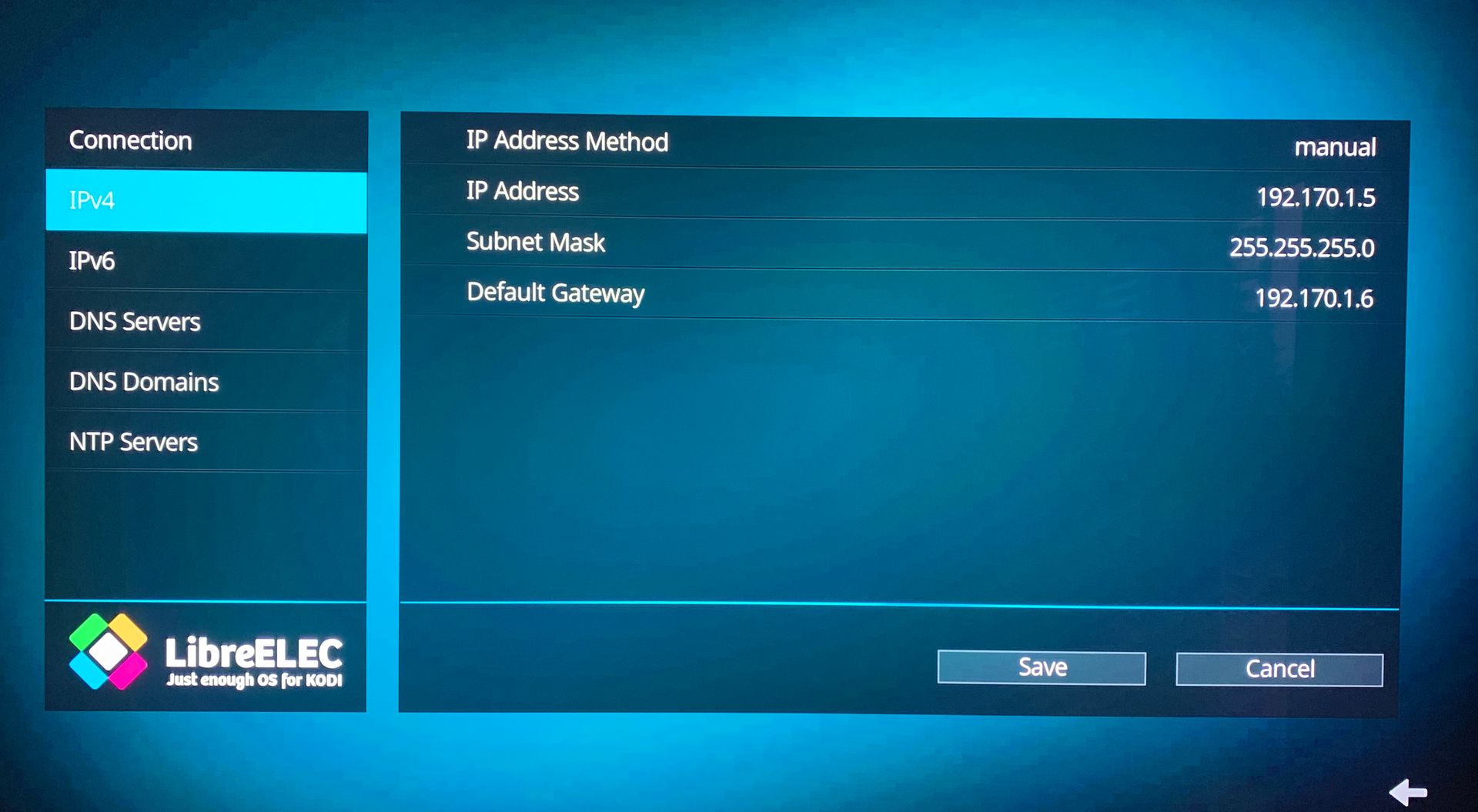

    RP2 {address 192.170.1.5, netmask 255.255.255.0, gateway 192.170.1.6}:
    Do you have any idea how I can configure RP1 to have a unique static IP within the same network as RP2?
    THX and BR Marco

  • Two options:
    a) Configure a static IPv4 address in LE settings add-on (network) settings
    b) Configure the router with a static DHCP reservation for the MAC of each RPi device
    I would personally do 'B' because this means the DHCP assigned IP is persistent over reinstallations of the device and copy/pasting things to a router GUI is usually quicker than entering details with a remote control (nothing has a keyboard attached in my setup).

    thanks again! I could solve it finally. I have choosen your first option:
    Quote
    Similar for openmediavault on RP1. There it was a bit complicated because I did that via the web interface while RP1 was connected to my Router. Finally, both RP1 and RP2 can communicate with each other via direct communication (peer-to-peer). I also could successfully sharing a folder with SMB on RP1 and include the shared folder into my RP2. Then, running a 4k60Hz movie with Kodi works as expected. THX!
    Here my network settings on RP1 and RP2:
    RP1: {address 192.170.1.6, netmask 255.255.255.0, gateway 192.170.1.5}
    RP2: {address 192.170.1.5, netmask 255.255.255.0, gateway 192.170.1.6}

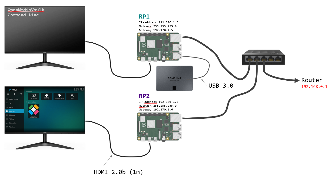

    I have no idea if this will work (mainly because I've not tried it) but two thoughts did occur 1) enable wifi on RP1 and use that to connect to the router or 2) pop a mini hub in, plug into RP1 and make the other connections through that that would allow the router to be part of the setup.
  • Hello @LybsterKodi,
    thanks for help! I would choose your option 2.
    Quote
    But I am not sure if I understand you correctly. Do you mean like this: see picture below. Is this what you mean? If yes, I do not know if this would work because then both RP1 and RP2 are connected to my Router and are in the same subnet as my Router, right? But this is not what I want. i want clearly an separate system: direct communication or peer-to-peer. The reason for this is I want the maximum bitrate when I am streaming 4k60Hz iso files. I already tried it it works perfect (no buffering). But with this seperate system I an not able to access the openmediavault web interface.
  • Yes, your diagram is what I meant by that option.
    Unfortunately, you seem to have conflicting requirements. You cannot have an isolated system with the two Pis and connect to one of them from outside of that system. Just can't be done.

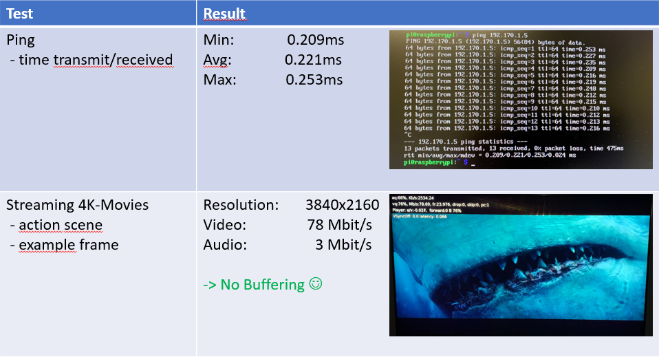

    3. I checked some action scenes of the 4k Movie "The Meg, 2018" with Kodi on my Media-Player (RP2). I could measure around 80 Mbit/s. But there are other movies with around 100 Mbit/s (like the Transformers movie series)

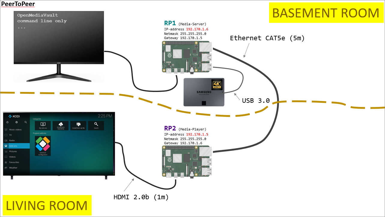

    OptionA (Direct communication or PeerToPeer)
    • ToDo:
      1. configure static IP-address of RP1
      2. configure static IP-address of RP2
    • Setup:
    • Result: PERFECT (no issues so far)
    • Performance Test:

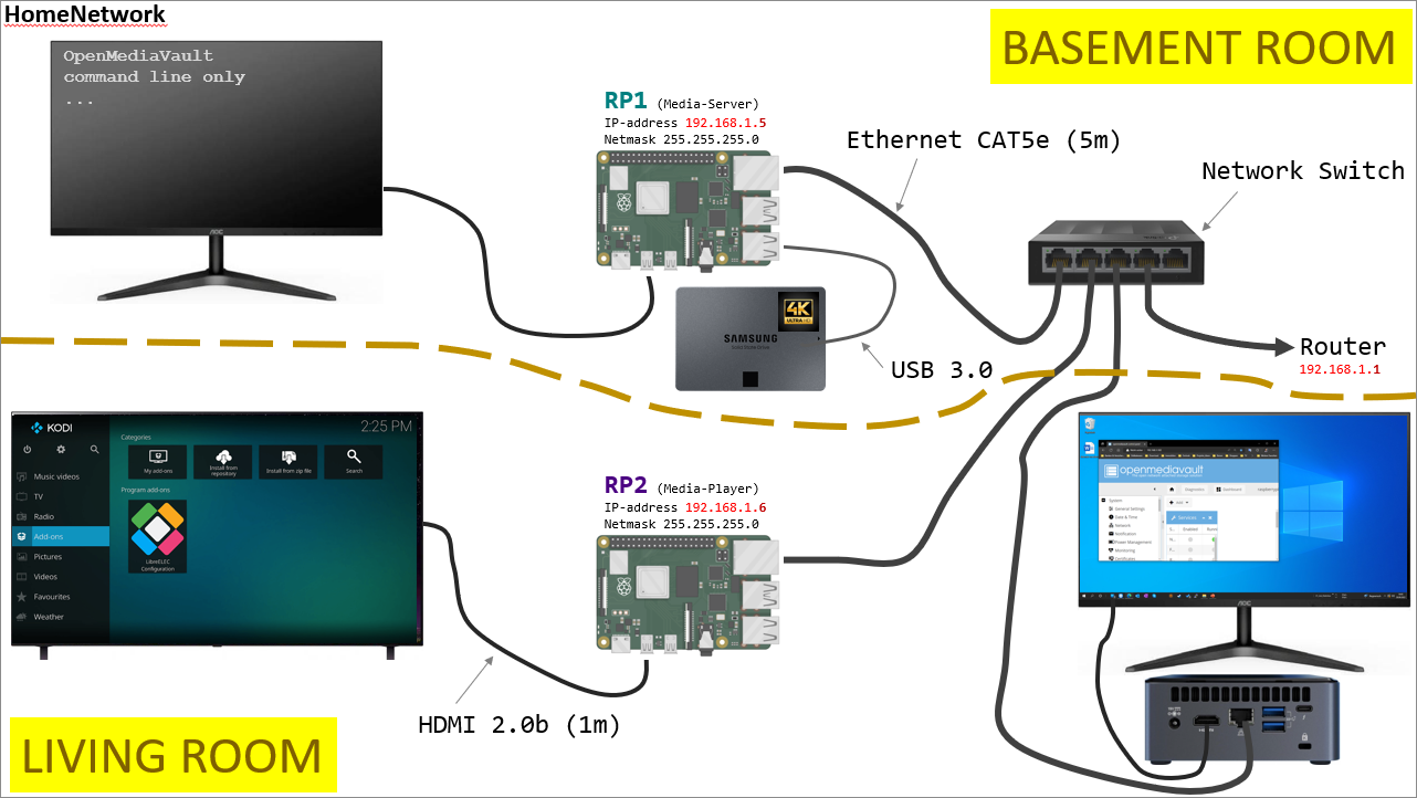

    OptionB (communication via network switch)
    • Setup:
    • Result: ... will add my result soon
    • Performance Test: ... will add my performance tests soon
