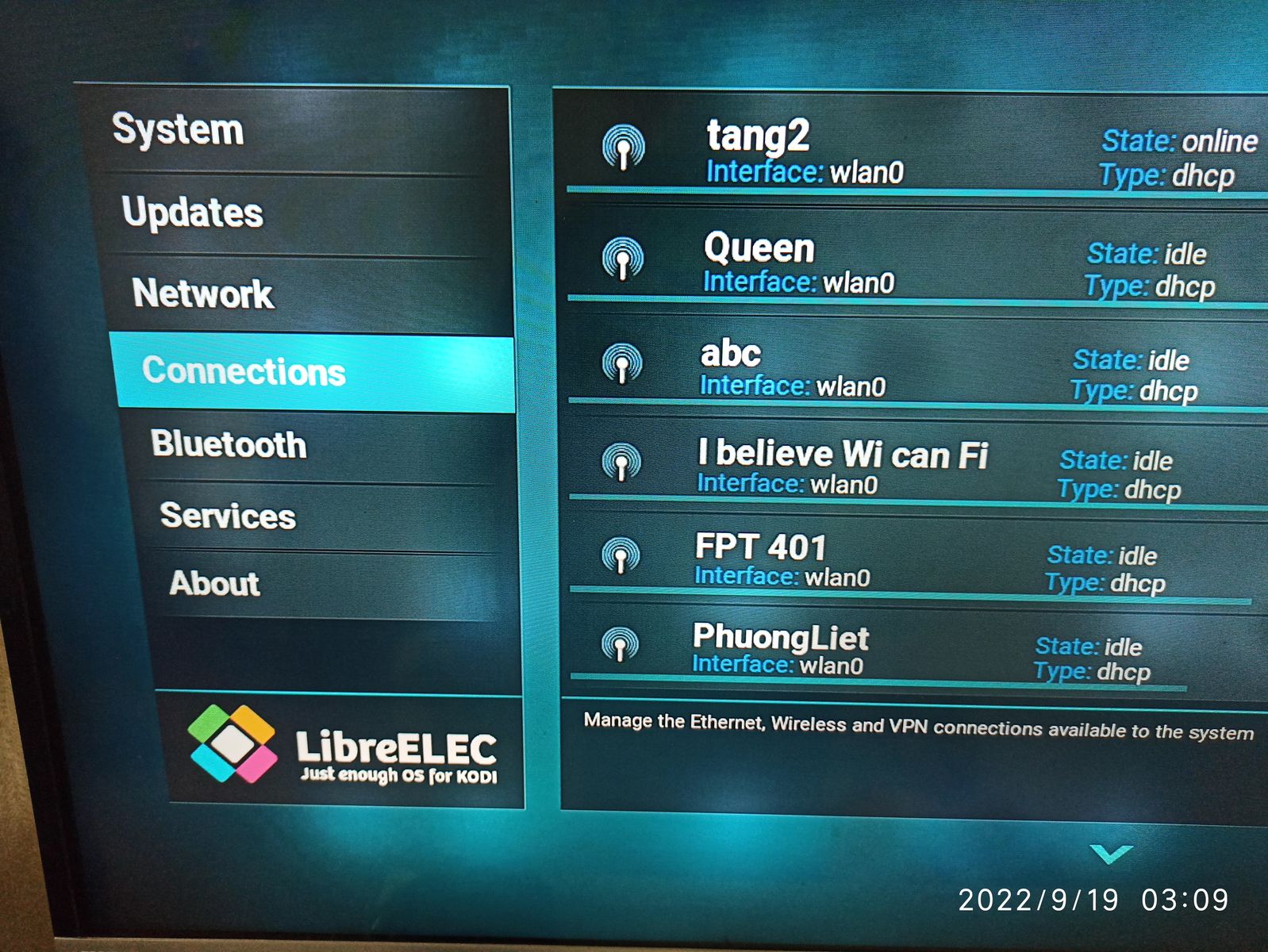

    I have a orange pi plus 2, libre 10.0.2 stable running so good but i want to use wifi on my device. I know stable version doesn't support it so i try to build my own firmware but it fails with the following error:

    Thank you so much, my vm settings is too weak, this problem is now resolved.
