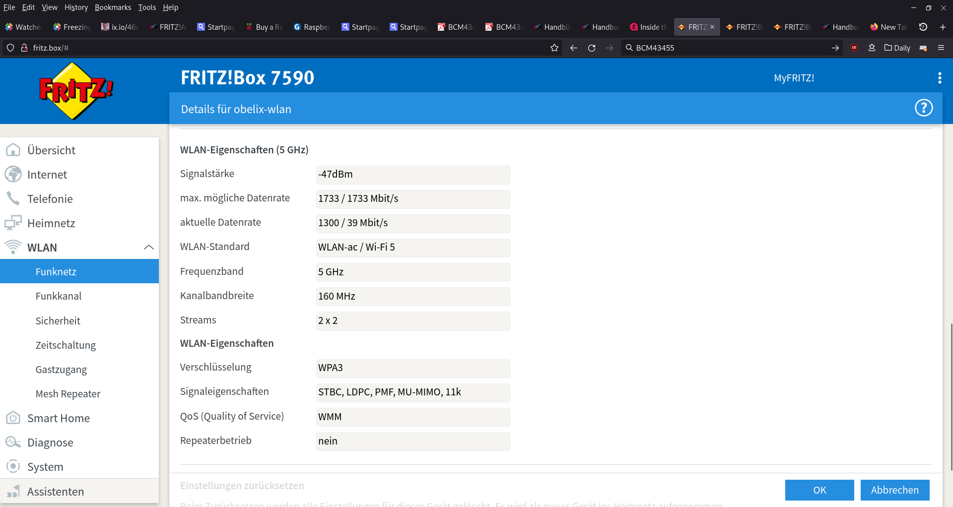

    screenshot from my FB 7590 and a connected AX201
