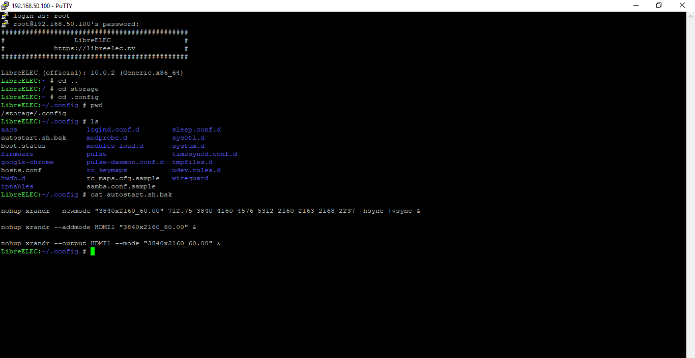

    Thanks for pointing me in the right direction. I am not 100% sure how to do it, is there a relevant short guide ?
  • but this is the only way to say "after X11 services start, before kodi.target starts"
    This condition is already fulfilled for autostart.sh with After=graphical.target and Before=kodi.service.
    But X11 startup may take so long that a sleep 3 or similar is required at start of the script.
  • Code
    sleep 3
    xrandr --newmode "3840x2160_60.00" 712.75 3840 4160 4576 5312 2160 2163 2168 2237 -hsync +vsync
    xrandr --addmode HDMI1 "3840x2160_60.00"
    xrandr --output HDMI1 --mode "3840x2160_60.00"
    ^ Try that. It runs the commands in the background after waiting 3 secs for X11 to start. Even if 4K60 is working in nightles your issue is the EDID data read from HDMI does not provide that modeline, so you'll still need to add it.
