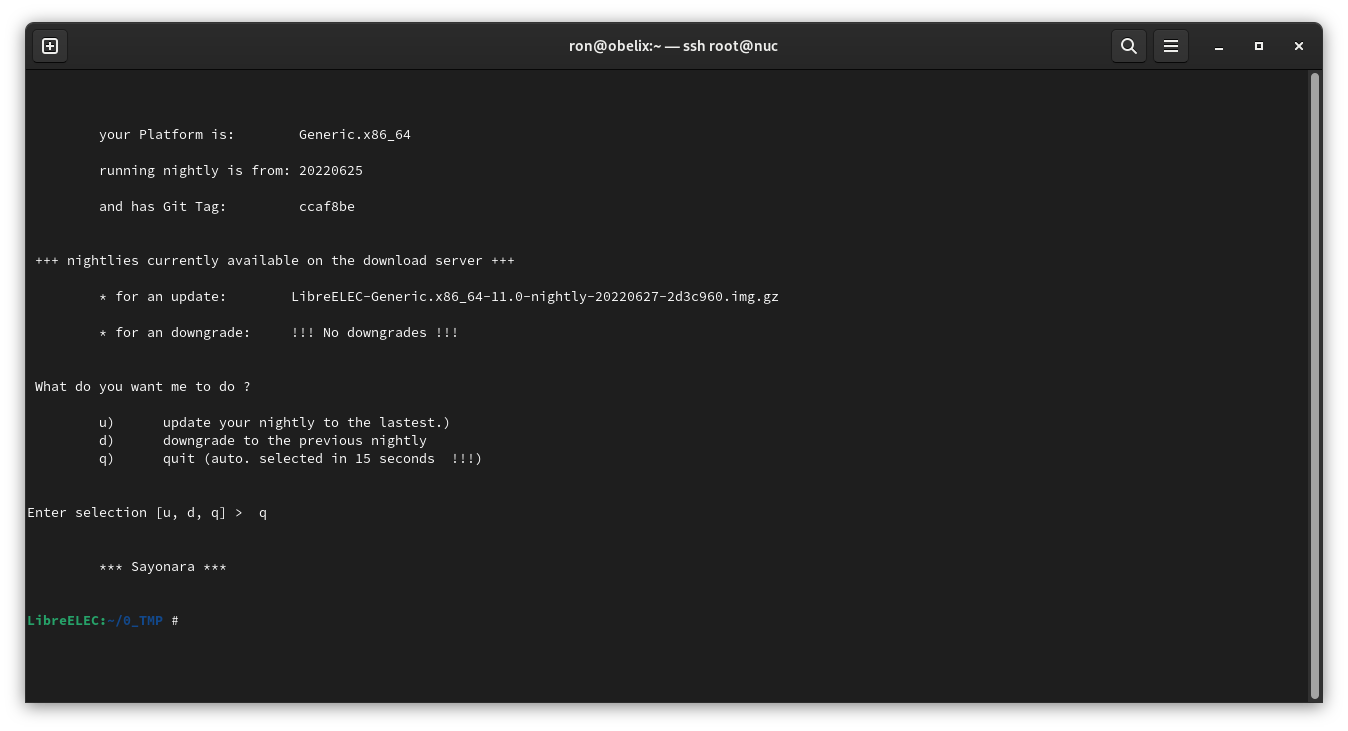

    now, and also before your comment #46, too ?
    see my attached screenshot:
    I'm like you on "ccaf8be"
    and I test the script daily with the download server side in an browser open
    And today, besides the above message that the new image is under downgrade, ...
    and
    I forgot to mention that the upgrade and downgrade options appear properly on the rpi.
    seems to be a contradiction
    me is confused
