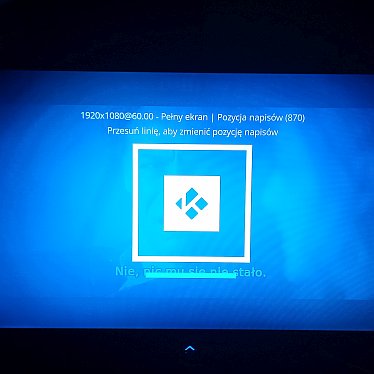

  • I did more tests and I was wrong. The problem is not the codec, but the video aspect ratio.
    Incorrect subtitle position occurs at aspect ratio 1.85:1, 1.78:1.
    For example video aspect ratio 1.78:1, subtitle position on video calibration settings
    8391-clipboard02-jpg

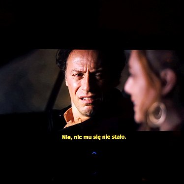

    and same text but position much lower (below bottom of movie) after closing settings
    8392-clipboard01-jpg
    I haven't found the problem (so far) when the aspect ratio > 2:1
