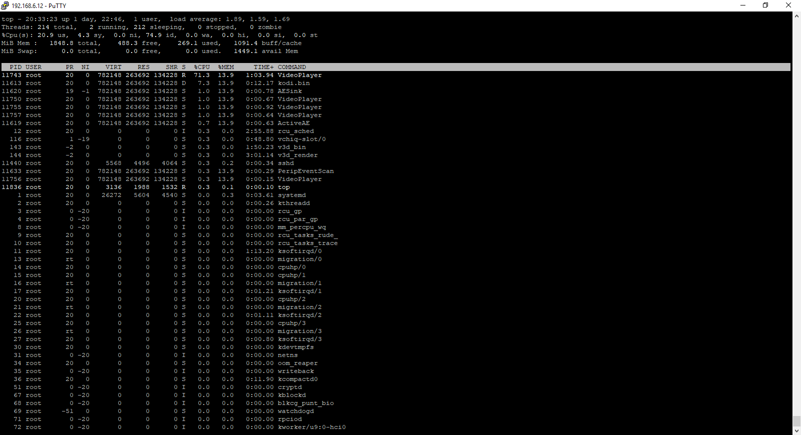

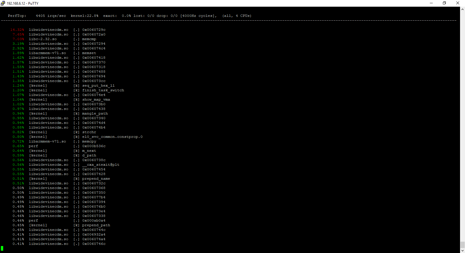

  • Sorry, I didn't have notifications setup yet.
    perf top when the issue is there:
    top H when the issue is there:

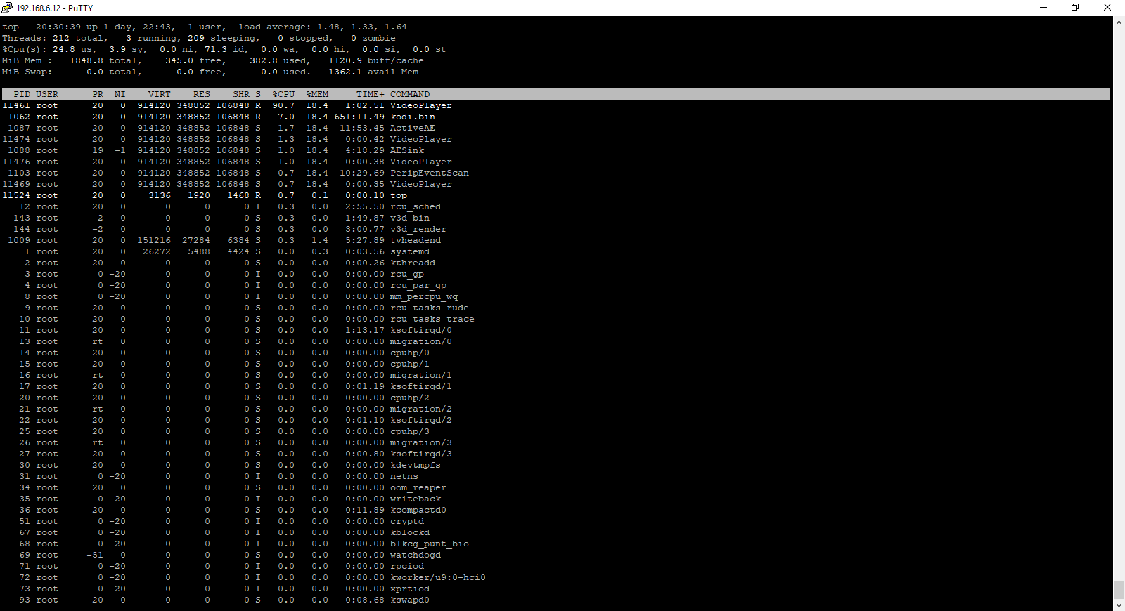

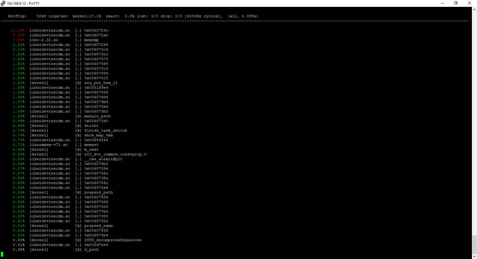

    after killing kodi.bin, perf top without the issue:
    top H without the issue:
    It seems videoplayer consumes a bit less CPU after killing kodi. I can mostly trigger the issue, as said by turning of the TV and receiver. It seems it doesn't like the HDMI reset or something.
