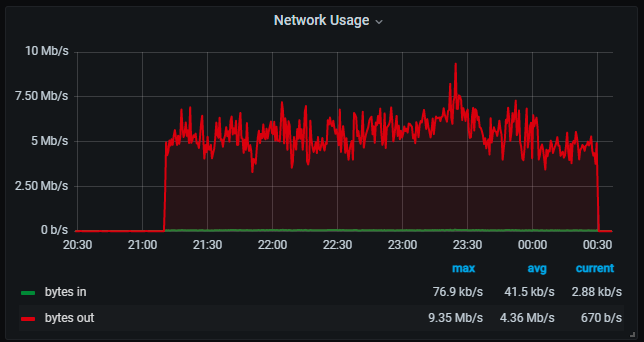

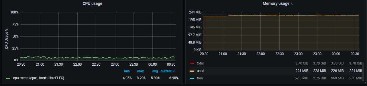

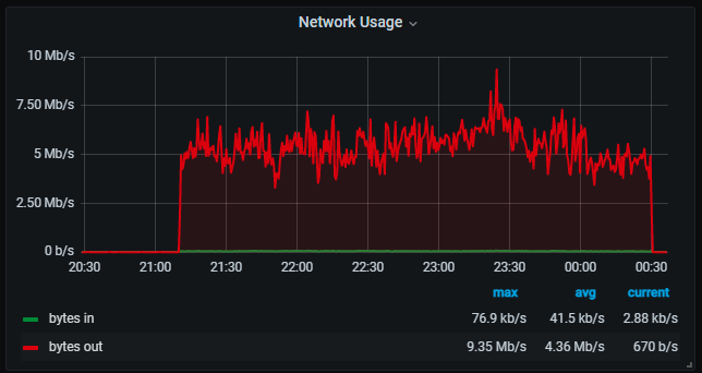

  • I did many changes, to try to improve the situation:
    - I saw that the TVH Server had the pass stream set as default; I understood it should be set as htsp, so I changed that
    - I disabled samba and disabled avahi
    - I have removed many EPG updates not related to my country or providers (I just left OTA EPG)

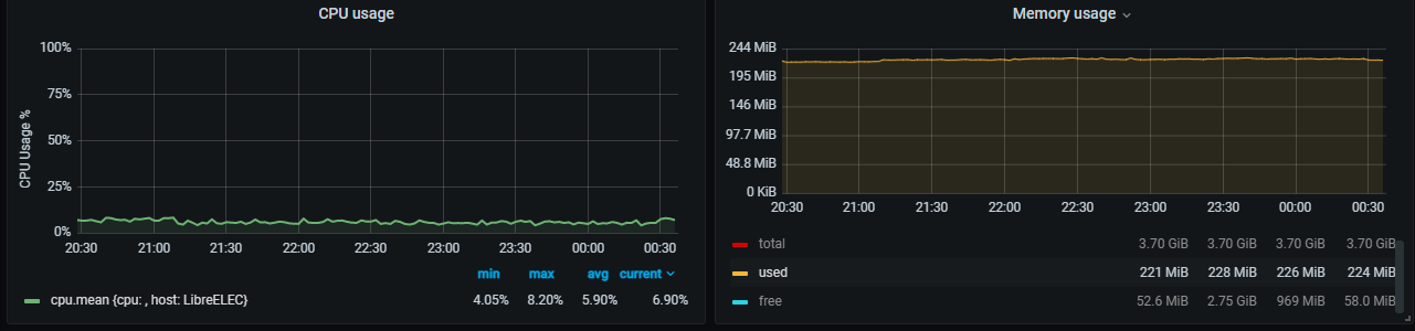

    I recorded my TV program and this part has always worked well. The duration of the recording is 220 minutes, so if I had had network issues I would have seen them. Instead, it all went well: no network errors, good upload bitrate, no CPU spikes, used MEM is good.

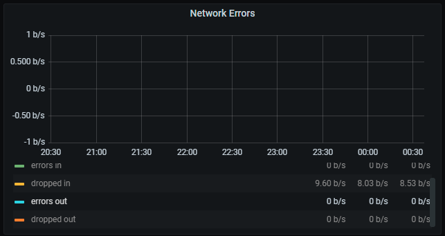

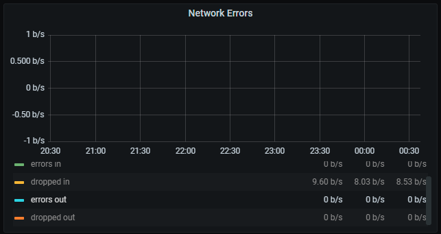

    I have some "dropped in" errors, don't know what it is. This happens continuously, not only when I am recording.

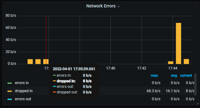

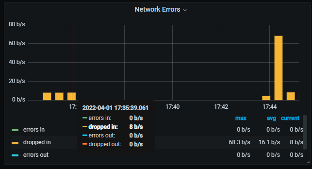

  • I have just seen an interesting thing: my LibreELEC got disconnected from the network, BUT the events are strange:
    I see the first errors in the logs at 17:39:07, with NFS that cannot be reached - there is nothing before this
    Apr 01 17:39:07 LibreELEC kernel: nfs: server 192.168.1.120 not responding, still trying
    but I stop reporting data about my network at 17:35
    During the hole (I send the data to an external server, so you don't see any data when the WiFi is down, but I also stored them in the LibreELEC) I don't see any errors in the interface (which is strange): err_in and err_out always report 0.
    WiFi gets disconnected at 17:43:26 on the LibreELEC and at the same time I see a similar log in my router (it was the router to de-register the device)
    WiFi is reestablished at 17:43:32, just 6 seconds later.
    So it looks like there is a problem with the WiFi which is not detected by anyone until very late in some cases. This causes network drops and as soon as the WiFi is removed and re-added, it all works fine.
    Maybe I could force a disconnection if I see problems? But how?
