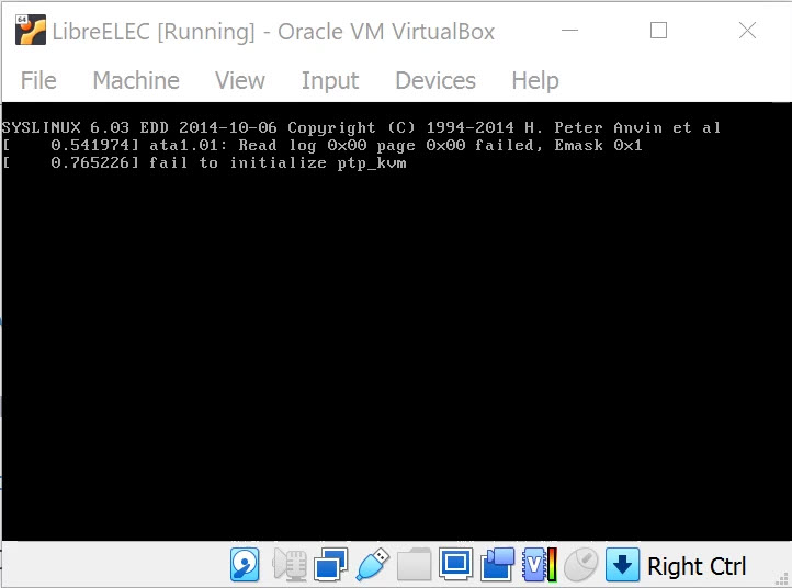

    So I removed the USB by deleting that storage in Virtualbox settings and then it just boots with an error, and then sits there with "LibreELEC (official): 11.0.3" on the screen.
    Any ideas, as there don't seem to be any guides on this...

    Thanks! So what I tried as a result, was to add a new disk as above, but not delete the old USB one. Then when the vbox boots up, I use f12 to select the boot drive, and select the new one I created. I guess I can't delete the other as it's primary, however at least that's working enough for me to do the testing I need to do. Thanks again!
