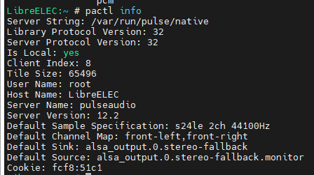

  • Ok now I am on PulseAudio now and trying to set correctly the quality with my DAC:
    I modify daemon.conf as follow:
    default-sample-format = s24le
    default-sample-rate = 44100
    alternate-sample-rate = 96000
    default-sample-channels = 2
    default-channel-map = front-left,front-right
    If I digit
    pactl info
    everything looks ok:

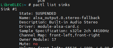

    but if I digit:
    pactl list sinks
    I have the following:
    Same for pact list sources where I have 32 bit.
    Why in the sinks the bit are 32 when I set 24 on the daemon.conf?
