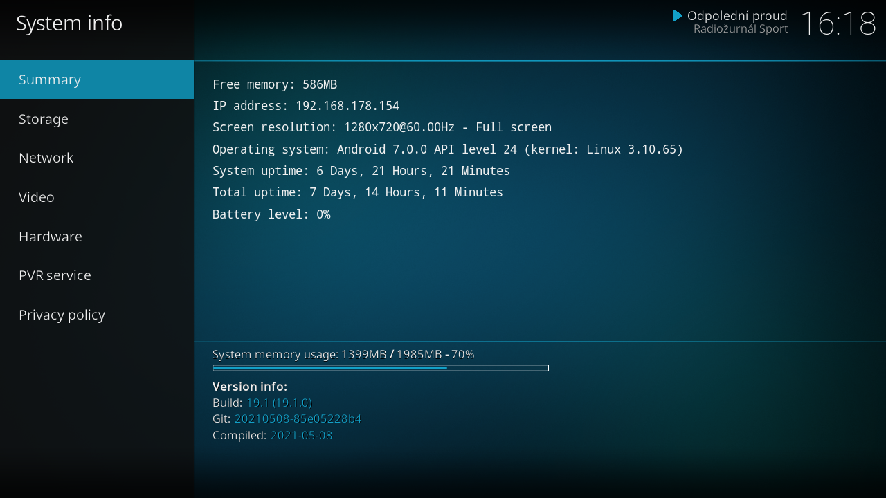

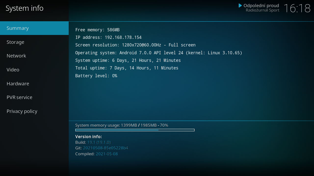

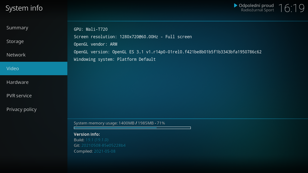

    Finally, I installed the Android 7 OS on the SD card and then Kodi. This is a combination you can live with, at least on a small monitor.
    I let it run for a week and everything was fine. The problem did not occur. I am aware that this is not entirely sufficient proof that the board is OK. But I only have one piece.

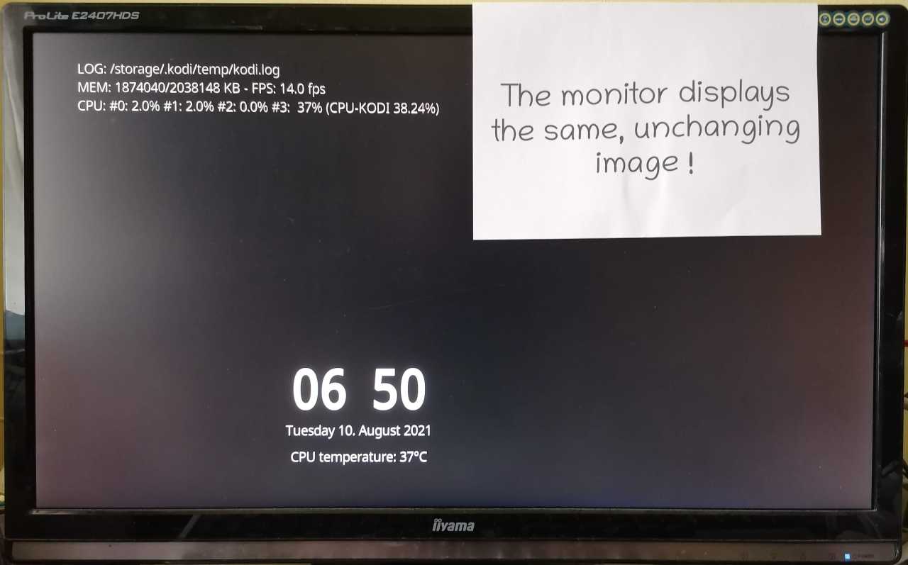

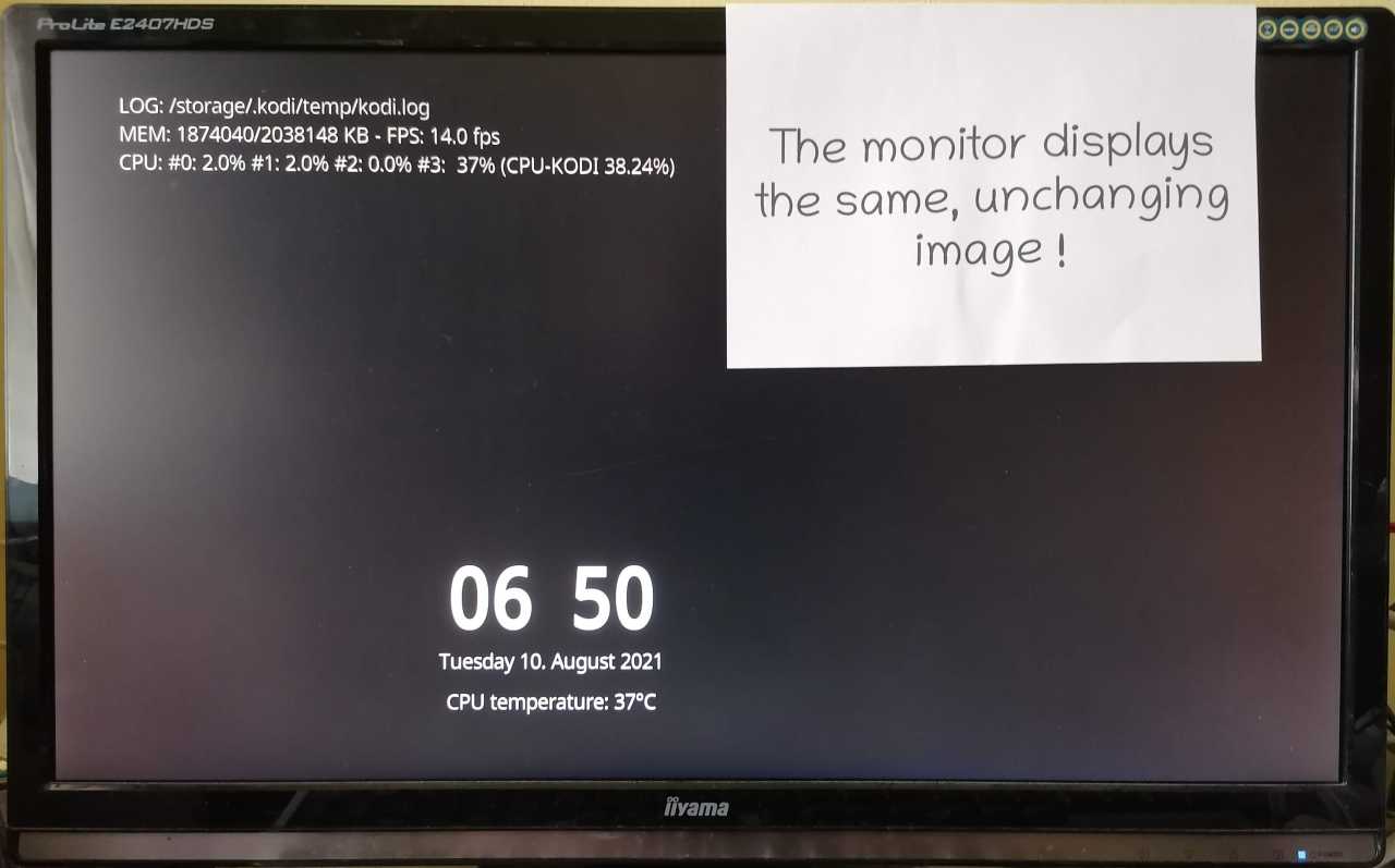

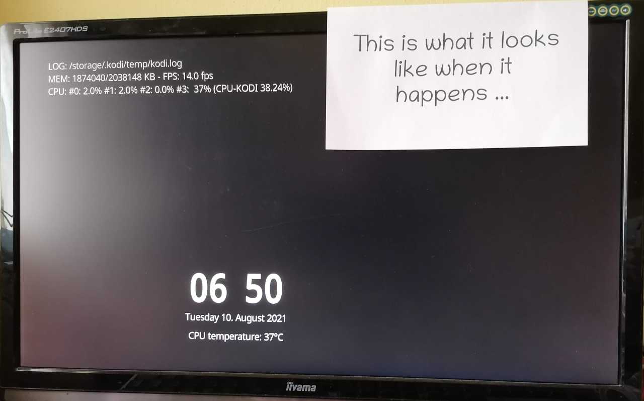

    The course of the test was that I enabled the debug log and rebooted.
    The screensaver started automatically and the photos show that the freeze occurred at 06:50, while the last entry in the kodi.log was at 06:32:37.
    I was surprised that the serial console log contains only the system boot and then nothing.
