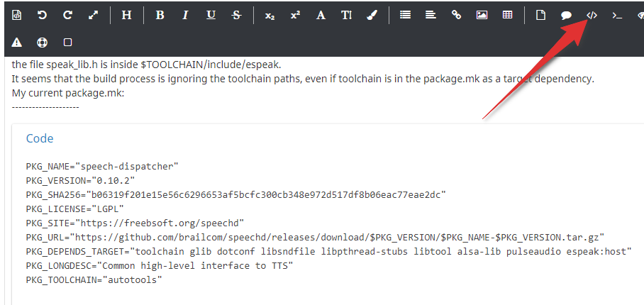

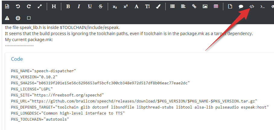

    I'm trying to generate the eSpeak Module, but it needs the espeak library for the process, so I added espeak:host as a dependency.
    The eSpeak package wasn't able to generate host builds, so I edited it and could add the eSpeak libraries and include headers to the toolchain. However, when trying to build Speech Dispatcher with espeak support it says that file <espeak/speak_lib.h> does not exist, but the file speak_lib.h is inside $TOOLCHAIN/include/espeak.
    It seems that the build process is ignoring the toolchain paths, even if toolchain is in the package.mk as a target dependency.
    My current package.mk:
  • Actually, eSpeak builds a library (libespeak.so) used by Speech Dispatcher, but it builds a static library too (.a file) and a header (speak_lib.h) which are needed to build the eSpeak module into Speech Dispatcher.
    Here is the package.mk for eSpeak:
    I've tried with espeak:host and with espeak, but in any case it throws the same error.
