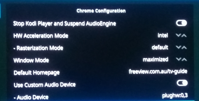

    Hey champions, I've been meaning to ask this for ages...

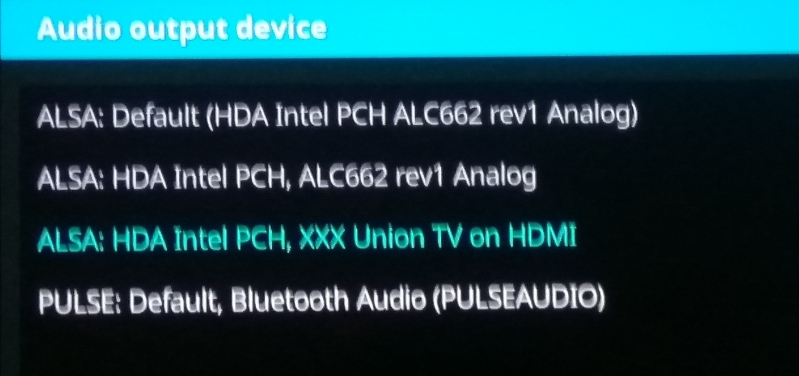

    I got some luck out of the above method of turning on 'use custom audio device' and adding in the info 'plughw:'
    In this case 'plughw:0,3', which i found after great effort trying many combos.
    The thing is...IT WORKS, but to get it to work on many key sites, you have to refresh the page many times.
    I was hoping for some guidance on this - I reckon there must be a fix for this that makes it work every time.

  • I'm having some chrome sound issues too. After putting in the custom audio device and then adding it into chrome-start script with the nano command, I now realized it is working fine if I first go to youtube. Somehow this activates the audio. So in the end, it wasn't a setting issue, but it was actually the problem you described here.
    Any update on progress on this?
