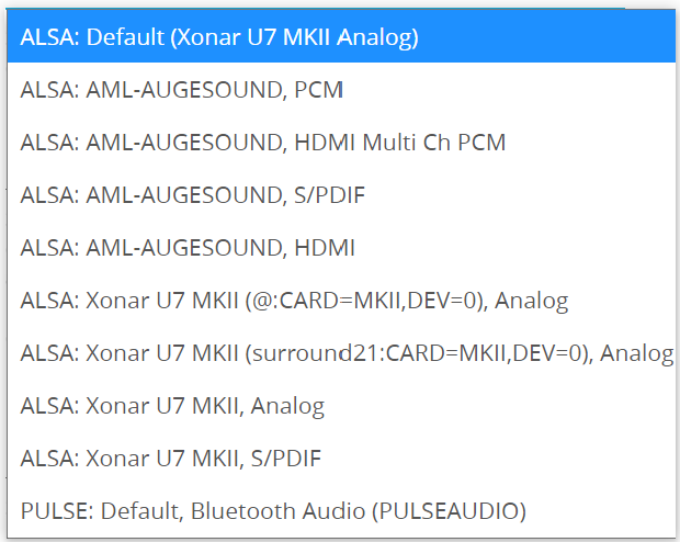

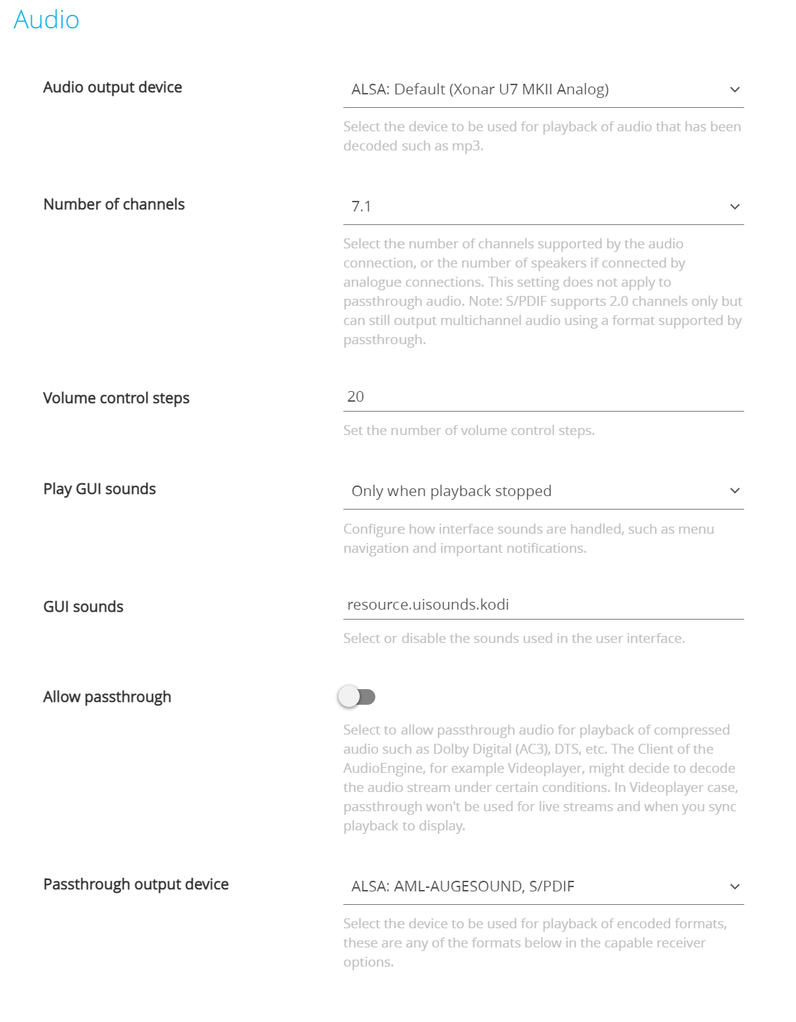

I have an issue I haven't been able to fix. The usb sound card [asus xonar u7 mkii] when selected to output analog 7.1 in kodi only outputs analog stereo. ![]()

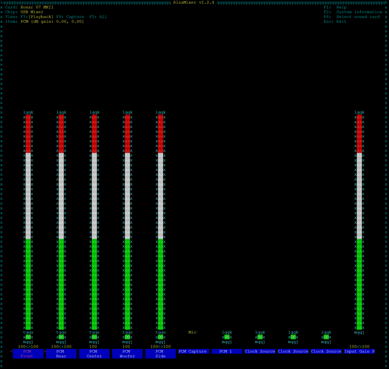

The kicker is that when using ssh the alsamixer shows all channels and playing 7.1 wav files with alsa works. However I try none of the setting in kodi give the slightest hint of more than stereo. It is as if it does not know that there are more channels. I tried with alsa configuration but I don't seem to lead me any closer to a fix.
