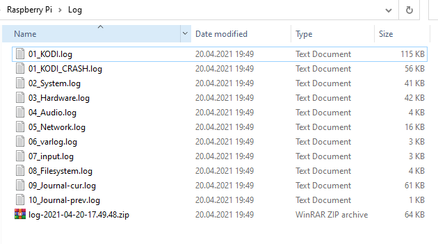

    Attached are the logs of RPi3 and RPi4, both with same settings below:

  • Ok, I'll get back roght away with a new log. The previous was after boot, without playing anything.
    New log after trying to play three tracks at 44.1/16, 96/24 and 192/24:
